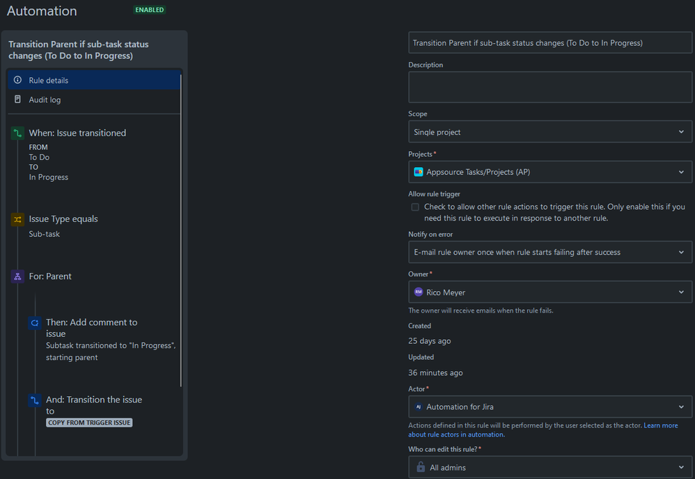

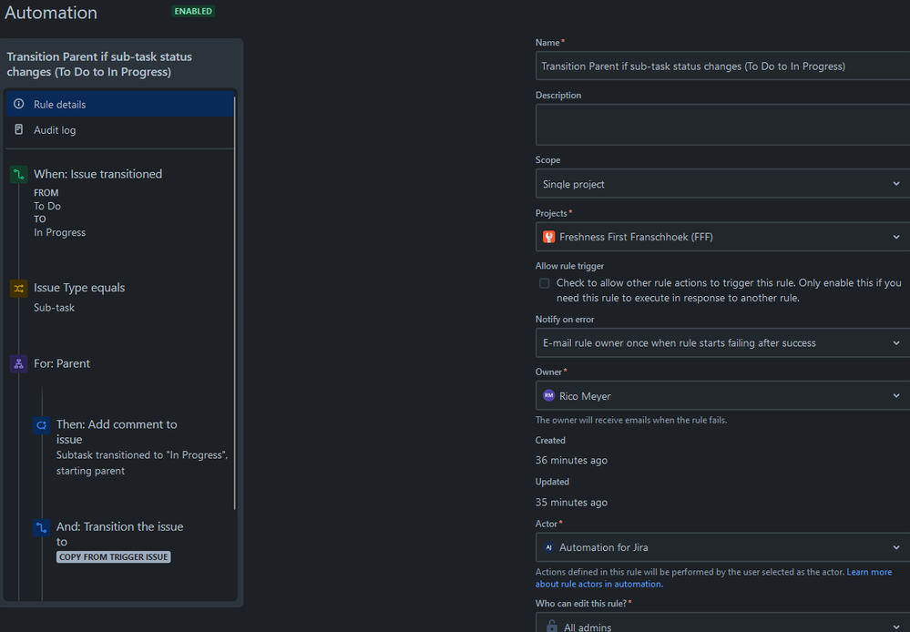

Rico Meyer
September 11, 2023
Hi Tessa
Thank you for the quick response.  See attached x2 screenshots, both rules are identical with the same actor and owner.

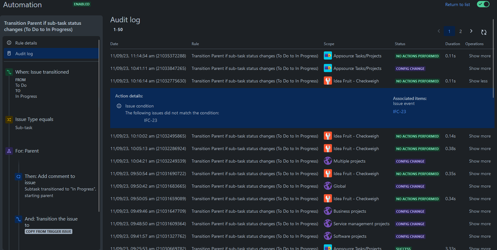

Rico Meyer
September 11, 2023
Hi Tessa
The rule seems to trigger but does nothing.
The audit log simply indicates "No action performed" with a further message indicating "The following issues did not match the condition:...".
Tessa Tuteleers
September 11, 2023
Okay, good! We know the permissions are okay and we have a good info message to work with.
Please check the IFC-23 issue, is it a subtask? Because if tasks / epics / stories / .. transition from "To do" to "In progress", they will trigger the rule too, but then the condition would fail.
Please create a test subtask specific to test this rule, make the transition and see what the audit log tells you.

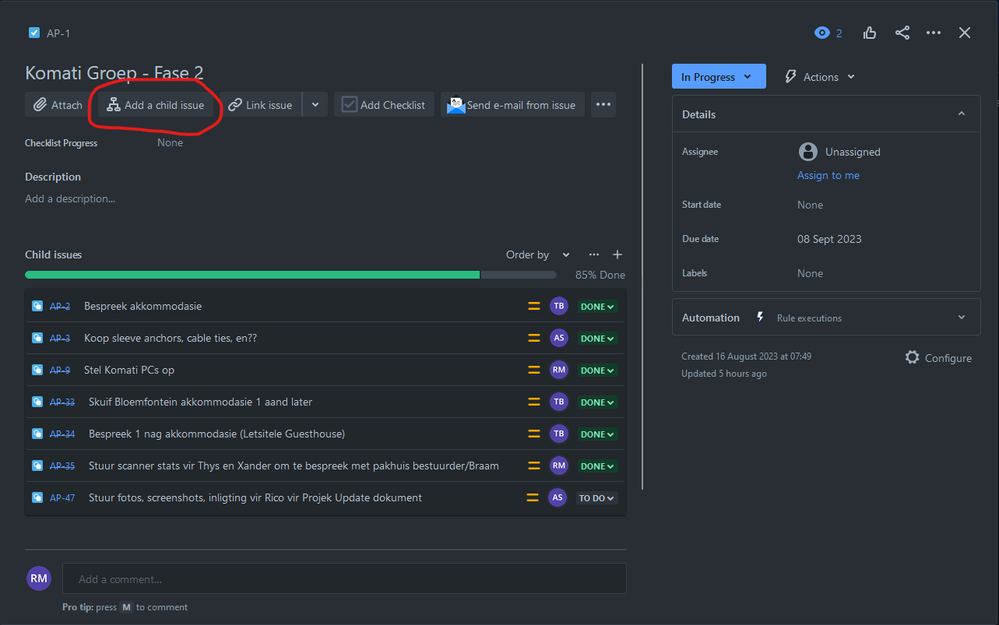

Rico Meyer
September 11, 2023
Hi Tessa
To my knowledge the task referred to as well as a number of other tasks are sub-tasks although within the parent it is called a "child issue".  See attached a screenshot of a parent with its listed "child issues" or also known as "sub-tasks".
The projects seems to be of the same type too, I checked whether the first one is perhaps of a different type and therfor working but not the case (all are listed as "Team-managed business" projects).
Regards

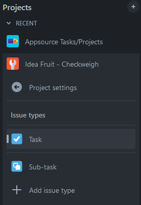

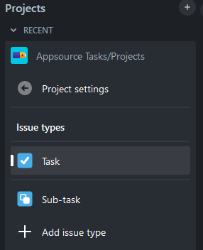

Rico Meyer
September 11, 2023
Hi Tessa
I have checked, on all my projects the task types are the same (Task & Sub-task) which in my opinion should mean that if automation triggers on the original project it should trigger on the others too.
What I have not done yet is to create new automation rules for each project, this should probably work but is not the route I wish to take as this will create a lot of configuration everytime a project is added.
Attached is x2 screenshots of the task types of x2 seperate projects.
