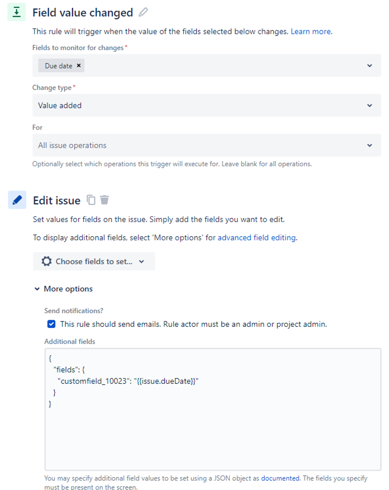

The full rule is pasted below. Essentially we have a custom field for "target end" that should populate with the value of "due date" when that field is initially populated (to preserve the initial target end date even when due date changes).
Even though we have "value added" as the change type instead of "any changes to this field value", it is triggering when due date is initially populated AND changed.

Ash Yadav
March 29, 2023
Hi Nikki,
At a glance the rule appears to be fine so my next course of action would be to check if there are any other automation or workflow rules that could be causing the field to be updated on any value change.
Do you have a snippet of the audit log of when this automation last fired? Might have some clues there.

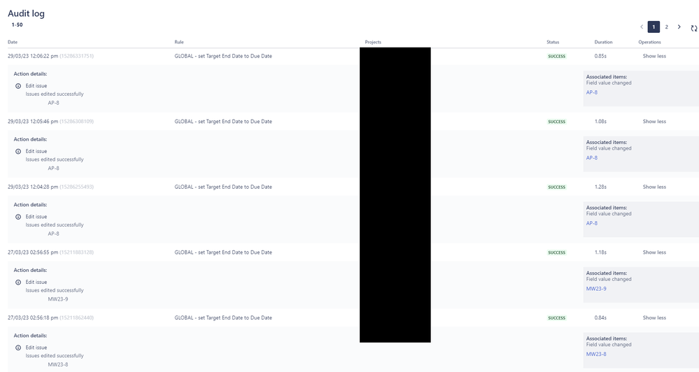

Here's a snippet of the audit log:

Ash Yadav
March 29, 2023
Hi Nikki,

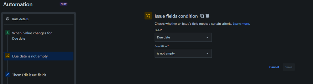

If I understand correctly, you want the automation rule only to fire when a value is added to the due date field but not changed correct? As in, the field should be empty and if it isn't, the rule shouldn't fire?
If that's the case you could add a condition to check if the due date field is empty first.
I'm not 100% sure that is what you're looking for but let me know.

Nikki Hylton
April 4, 2023
Hi @Ash
Thank you! That's exactly it, I tried adding the condition you suggested, and it's still triggering for edits.  However, I was able to use your direction and create an advanced compare condition, and that worked!
