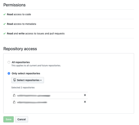

When I check the Jira app on GitHub is says everything is fine:

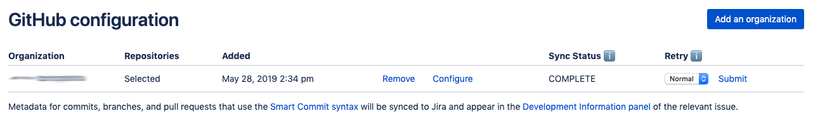

When I check the GitHub app in Jira, everything is fine too:
Triggering a full sync from withing Jira has no effect.

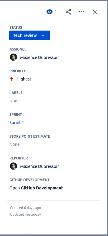

Hello @Angélica Luz ,
I have the same problem here and installing the other add-on for GitHub: Create GitHub Branches from Jira. Did not make the development panel to show up even if github plugin seems to be installed properly.
Did you have
Hi Maxence,
Welcome to Community!
As per your screenshot, everything seems correct.
When we use only GitHub it will show GitHub Development. The Development panel will only show if we also use Bitbucket.
