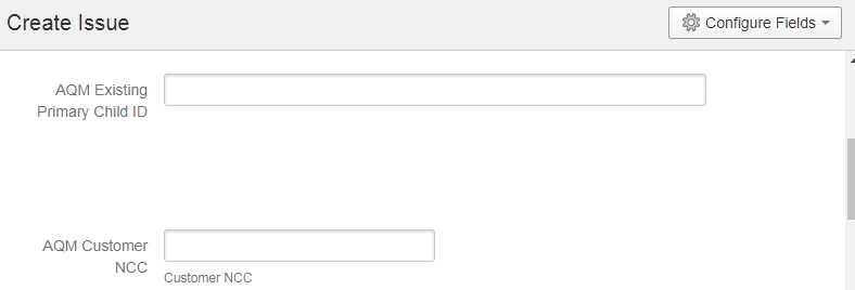

Getting white space between fields in the create issue screen,
Need Help !! Please suggest how to remove white spaces in the create issue screen.

What text do you have in the description of the first field?  Can you check that it's completely empty, no whitespace etc?
Also, try renaming the first field so it has a name that fits on one line.  This is a temporary test, just to see if that affects the layout at all

We have hided some fields using javascript, getting whitespaces at the place of hidden fields.

Ah.  You shouldn't do that.  If you don't want a field on a screen, remove it from the screen definition.

We need those fields too, but on selection of some radio button.
We have used script to hide first then showing fields on selection of drop down/radio button.
is it possible to remove whitespaces through CSS?

There's nothing you can do about this without hacking the core of Jira, or using something that implements your javascript properly (doing it in the announcements banner or field descriptions is a guaranteed failure).
The correct answer here is "stop hiding the fields if you need them".  Trust your users to get it right.
If you still can't do that, then you'll need to implement javascript hacks properly.  Done as add-ons that can get deep into the screen layouts.  The Behaviours module in ScriptRunnner does this, and can implement your show/hide quite easily.
