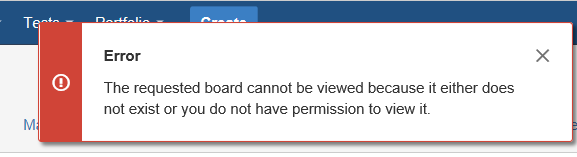

Hi All,
User getting the Error on th board as " The requested Board can't be viewed or you dont have permmision " . I have attached screenshot for your reference as well. Though user have all the required permissions ( Project Admin, Board Admin ) to the project getting the error.

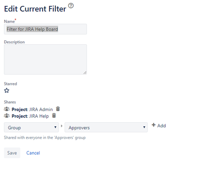

The user needs to have permissions to the filter used by the board. In other words the board filter has to be shared with the user.

You can't just share the filter with a project. It has to be shared with a Project Role or a Group or the Organization.
From the filter itself, you need to click on Details and see who it is shared with.

John Funk
May 14, 2020
Yes but what is the filter shared with?
Please post a screen shot of what the shared filter has. It should look something like this:

I have re-checked the filter is only shared only with PROJECT.
My question is those who have access to the project they can able to use the filter. Previous the user is able to access and now suddenly got that error. Is this any permission issue ?
Roja Gurram
May 15, 2020
Hi JOHN,
I have resolved myself. This is permission issue though user have PROJECT Role Admin permission and user dont have Browse project permission .
