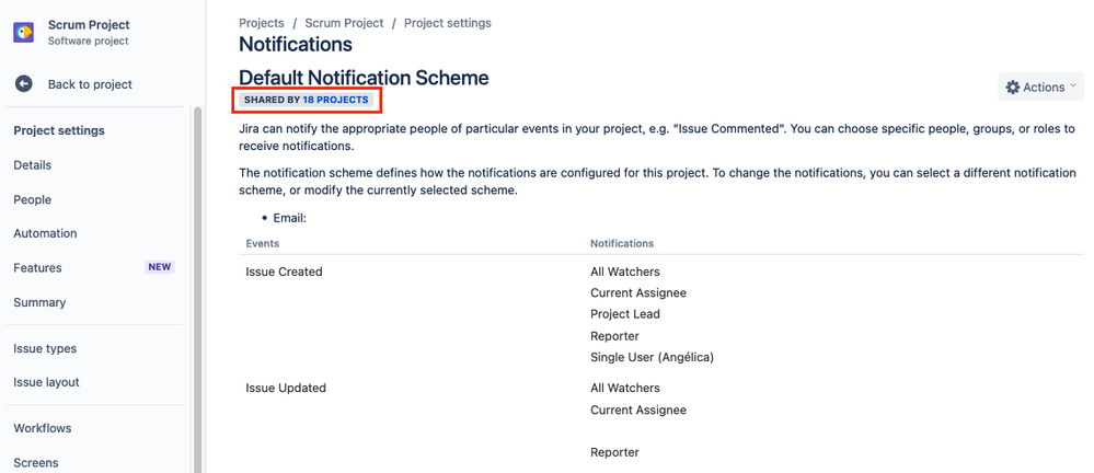

Hello @Vishal Zanzrukia,
Thank you for reaching out to Atlassian Community!
On Jira, in case you are using company-managed projects, the notification scheme can be shared between them.
With this said, if you are receiving notifications of other projects, maybe a group you are a member of was added to the notification scheme and the scheme is shared between projects A, B, and C.
If you are an administrator, please go to Project settings > Notifications and confirm if the scheme is shared and what groups, roles, or users are set to receive notifications for specific events.
If not, please reach out to the administrator so they can check and fix it.

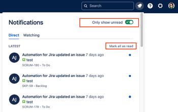

Also, why can't see "Mark as Read" and "Clear" two different options anymore, it was too good to manage my todo from notifications itself. When I read notification, I may still have pending action on it, so I clear it when my pending action is done too.
If it’s related to the bell icon, the options are there. You can mark the notifications as read the the “Clear” would be the “Only show unread”.
