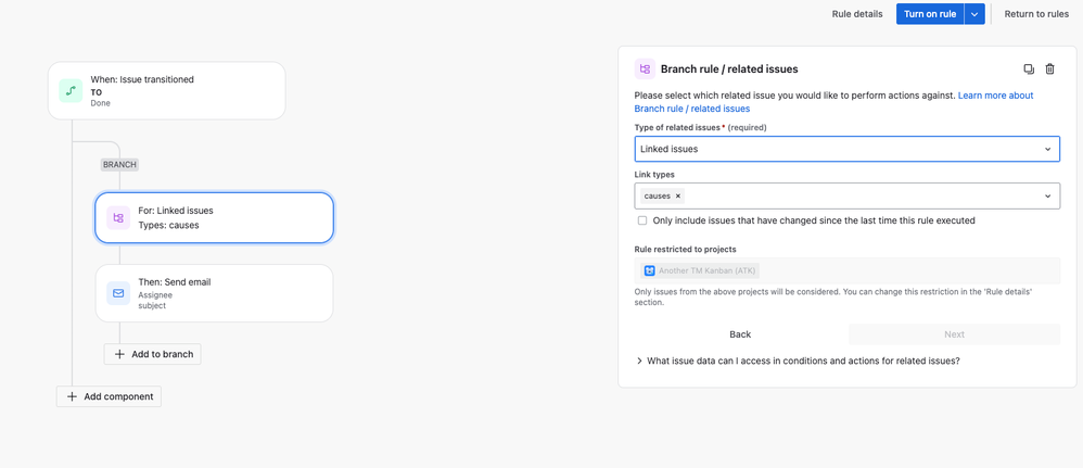

Hello @Sean Somerville
One solution would be to use Issue Linking to establish a relationship between the two issues, like depends on/is depended on by. You could then use an Automation Rule triggered by an issue transition to Done. In the rule you could then check if the transitioned issue has any linked issues that are linked as is depended on by. You could then use the Send Email action in the rule to send an email to the Assignee of the dependent issue.

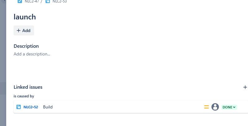

Screenshot 2025-02-21 133538.jpgHere I have them linked. I have 3 similar ones that look like this. two issues linked where one is caused by another. How do I set up a rule that when issue 1 is done, the person responsible for issue 2 is notified. In a clean, easy way.
Spitballing here: I want an email every time an issue switches from done, the person who is the assignee, will get the email that it is done. Without having to manually type that person's email into the rules. I want it to always send to the assignee of the linked task. Is that possible?

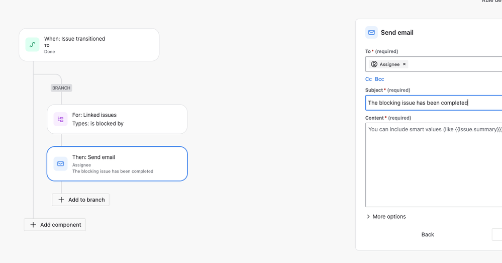

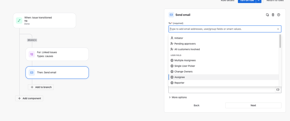

Yes, it is possible using the example I provided.
When issue NLCS-52 is transitioned to Done, for any issue linked to it with 'causes', an email will be sent to the Assignee of that linked issue.
Change the For Related Issues / Linked Issues to use the 'causes' link type.

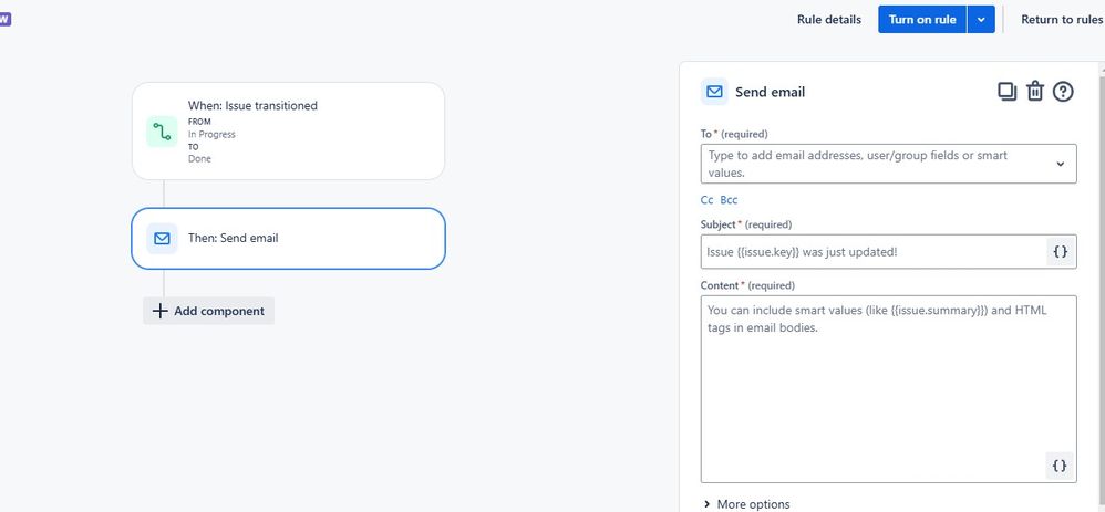

I looked it this. I got so close, but yet so far.
Person A is in charge of issue 1, and Person B is responsible for issue 2.
Issue 2 is dependent on issue 1 being completed.
Person C is the reporter, but they just assign the task, they don't need to know when issue 1 turns to DONE and issue 2 can be worked on.
As Person A, I could put Person B's email in there to let them know when it's completed. But is that the best way to do it? Would this be a rule on everything? Do I need to set up this transition for each child task I do? What are your thoughts?
