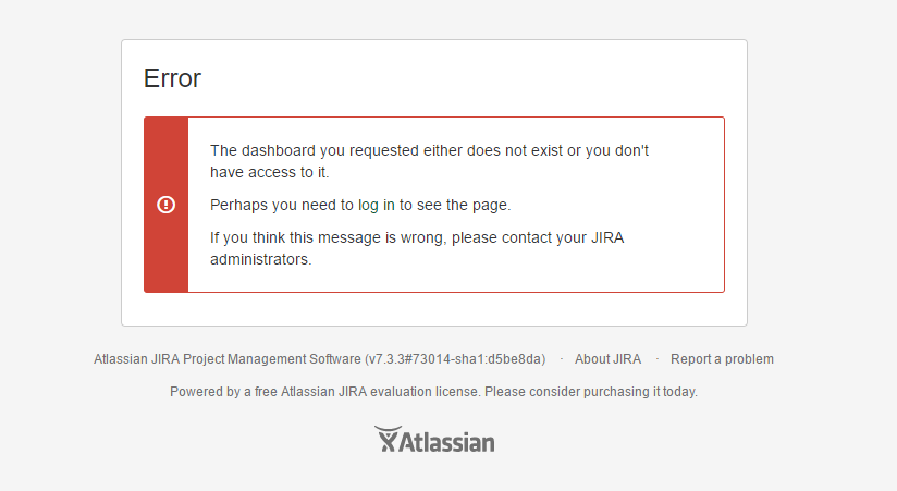

I have admin priviledges and can access every dashboard in my Jira project. All of a sudden today, I am getting logged out whenever I refresh the page on a dashboard or click on another dashboard. And I get this error. Has anyone experienced this before? Thanks.

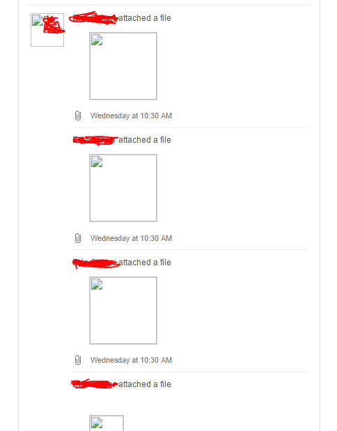

I have finally discovered the problem. I narrowed it down to one specific dashboard causing the problem, and then narrowed it down to one specific gadget on that dashboard causing the problem - the Activity Stream. One of my co-workers is included on that activity stream and he recently used the User Profiles for Jira add-on to upload profile photos for all of our agents and customers. The activity stream was showing these uploads in the feed as broken images. As soon as these activities were pushed down off the feed, the problem went away. I guess there is something with that add-on that didn't work right with the activity stream gadget.
This is what it looked like:
These activity logs were causing the dashboard system errors when refreshing and/or changing to a new page. This may be either a bug with the Activity Stream gadget or the User Profiles for Jira add-on.
Thank you for the assistance.

I think the error is just the standard error that is shown if you try to access a dashboard when you are not logged in.
So the question here is really: why are you getting logged out when viewing the dashboard?

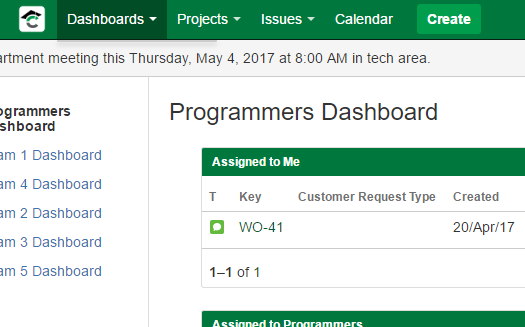

Tiffany Owen
May 11, 2017
Correct. I have tried on all browsers - same problem. It only happens while on the dashboard. I can access my menu items from project and issue view, etc. It only happens when I am currently looking at a dashboard and then try to access the menus up top or refresh the page.
In this screenshot, you can see that I am looking at my dashboard. However, I clicked on the menu items up top and no dropdown selections appear. Also, if I refresh the page, I instantly get logged out and get the error message shown above in the original question.
