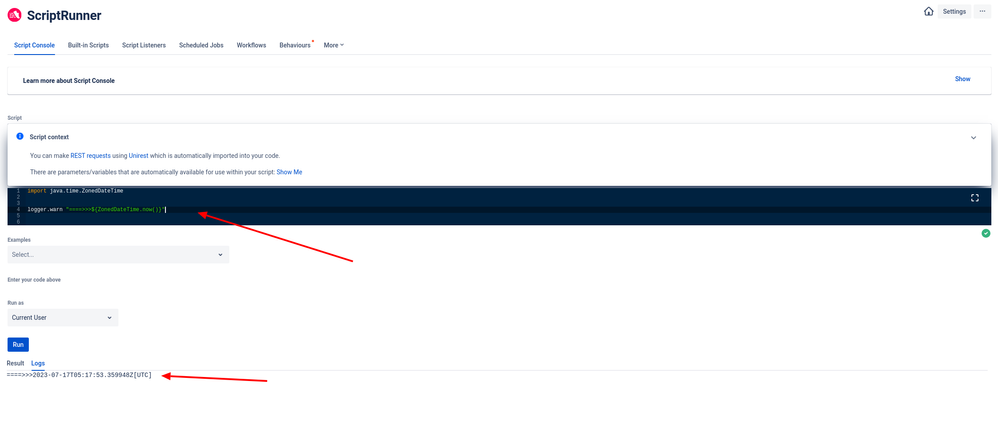

Could you change the approach you are trying to retrieve the Current Date by adding it to a log parameter as shown below:-
import java.time.ZonedDateTime
logger.warn "====>>>${ZonedDateTime.now()}"
This approach is working as shown in the screenshot below:-
I am suggesting this approach because it ScriptRunner in Jira could not directly able to read the value of the ZoneDateTime.now() and returns an exception.
I hope this helps to solve your question. :-)
