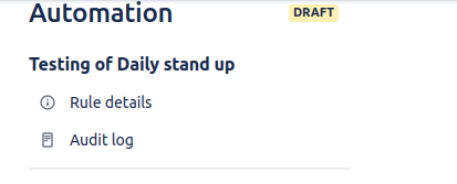

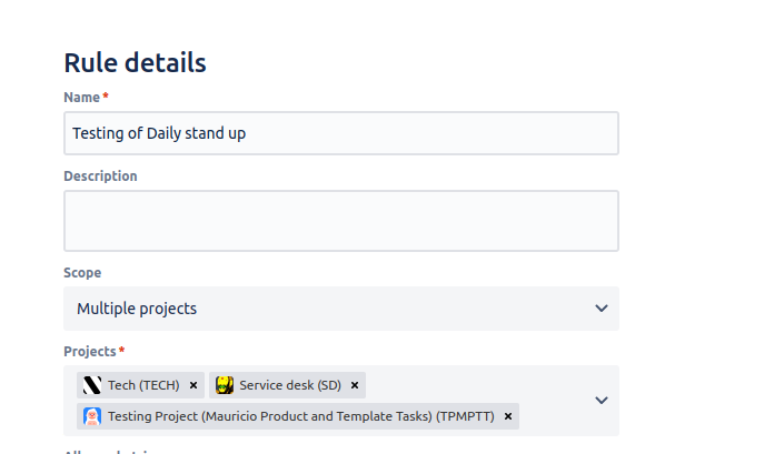

Hi Rafael, you can do it changing your Rule scope on Rule details.
And then select Multiple Project ( on Scope) and in Project the list of projects you want to do the search

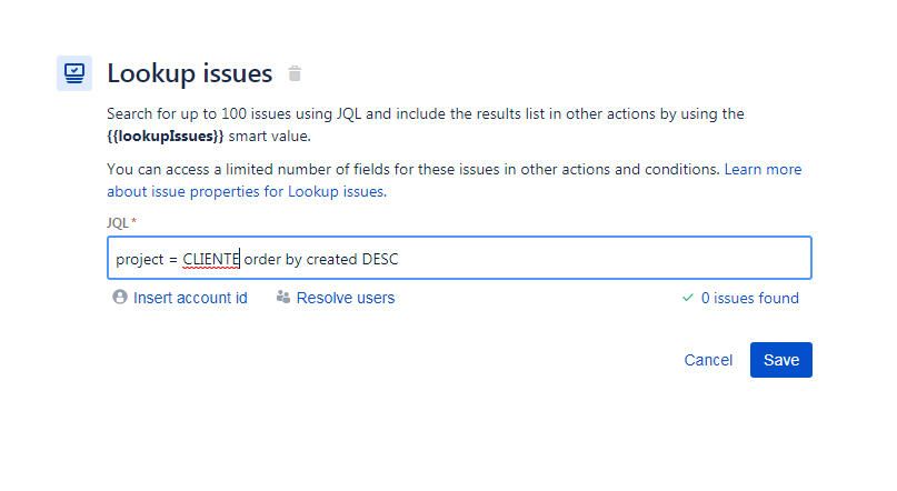

That is the problem, JQL does not bring anything back at all. I'm not filtering anything, it should show all issues from the other project.
In this picture, I'm on project A and trying a JQL on project "CLIENTE"
If I open automation for project "CLIENTE" and use same JQL, all issues will pop up. but if I change JQL to Project A, none will show up
I also tried on Global rules, all rules and project rules. result is the same.
