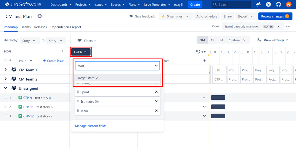

Can you check this option in the plan and let me know if you are able to add the start date and end date
Thanks
I can see this and add start and end date but that's possible only for Epics within a project. The problem is I am not able to add start and end date to overall project. Also, what will be more helpful is that overall project row should automatically pick the start and end dates based on Epics within it.
