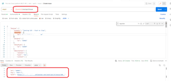

I checked the request in Postman, and it works with the body that you provided.
What custom fields are these? There is a chance that you've got to update the format for them
"customfield_10204", "customfield_10172"

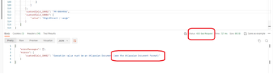

I tried a Multi-line text field and got this response :
Vigneshwar Kotha
November 16, 2023
Those two custom fields are Record Name and Severity. Record Name is text Field and Severity is a picklst field. Both values are getting as expected from salesforce. Fields type and access is same as other instances.

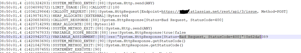

This is showing in my logs.

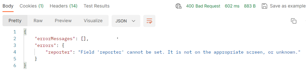

As you said, user Basic Auth with Username and API token. Getting bellow error.
When i remove Reporter from the payload, it is giving success. Can you please suggest ?
Vigneshwar Kotha
November 16, 2023
seems like this is the issue.
Like Jehan Bhathena likes this
Vigneshwar Kotha
November 16, 2023
I think reporter filed is not set in JIRA right ?
Jehan Bhathena
November 16, 2023
Yupp
That seems like it.
Try removing that from your Salesforce API body too and retry the API
