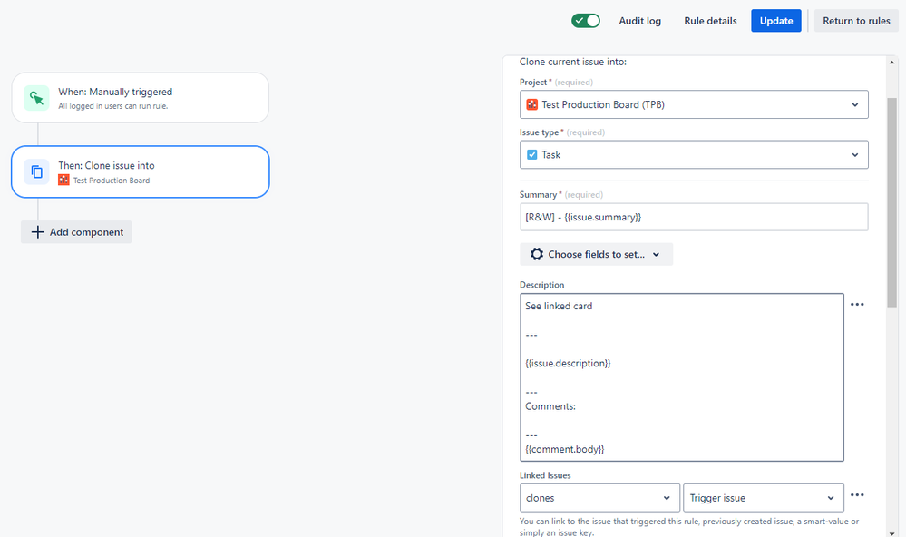

Hi Kristine,
Can you share a screenshot of your rule?
Kristine Lurane
April 16, 2024
Hi. Here you go. The "additional fields" also includes the JSON that Jira automatically suggest when you choose to clone something (below the image for reference), but I've tried it with and without that, and it makes no difference to the issue.

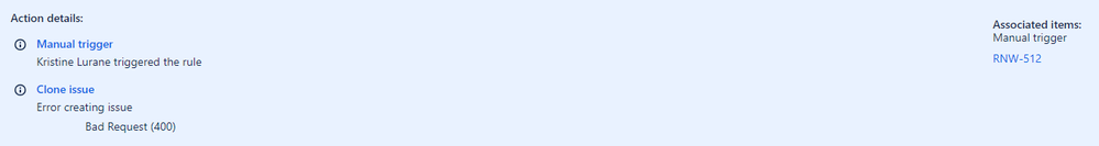

Can you also share the Audit Log for when you run it?
Kristine Lurane
April 17, 2024
Here you go:

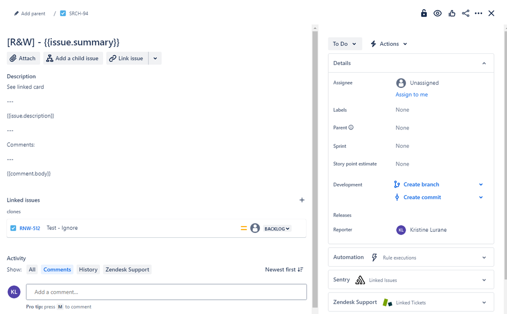

Okay, lets do this. Click the create button and then enter the data in the screen that matches the fields that you have in the rule. Don't add any values to any field except the fields you are using the in the rule for the Clone part. See if you can create or if there is an error or additional required fields.
Kristine Lurane
April 17, 2024
Created the card with no problems, linked as it should, etc.

Yes. Let's do one final thing and if that doesn't work, then it's probably time for a support ticket. Instead of doing a Clone action just do a Create Issue action and populate the fields as a Copy from Trigger Issue.

Hi @Kristine Lurane
Just to confirm, would you post an image of your entire Clone Issue action, perhaps using a scrolling browser, image capture?
Until we see that...this symptom could be reported when:
  • The edit issue action is trying to set the field twice, once with the dropdown list and once in the JSON.  From what you describe, it appears you are trying to add an issue link twice, and that is not supported by the REST API functions for issue create.
  • Someone has made a field required and that is not set during the issue create

John's last suggestion worked! Thank you very much for your help.
For the sake of anyone else who might be struggling, however, I'll answer the last questions as well:
1.) I tried the automation without the JSON and got the same result.
2.) Creating the issue tested the second theory (I also checked this in the settings for both boards) - there are no required fields set on either board.
Thank you again.
