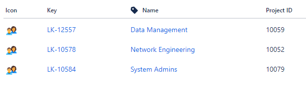

I've done this recently with a custom field, Teams, and an object in Assets that holds the values from the field along with a project id:

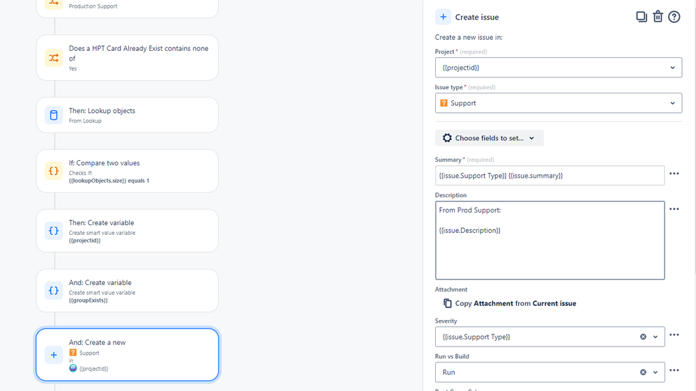

And then in the automation, I go lookup the Asset using AQL and use the value I get back from that to create a ticket in the appropriate project:
