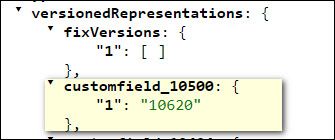

I am using the datacenter edition of JIRA (8.20.2) and its API and I have a customfield, customfield_10500 that can have one of multiple string values.
My problem is that I need to get the text value of the customfield, but I seem unable to get this information.
I have this data for a specific issue and the "customfield" returns an ID:
So I need the value of customfield ID 10620 - in my case it is the team name, e.g. "My Team 1".

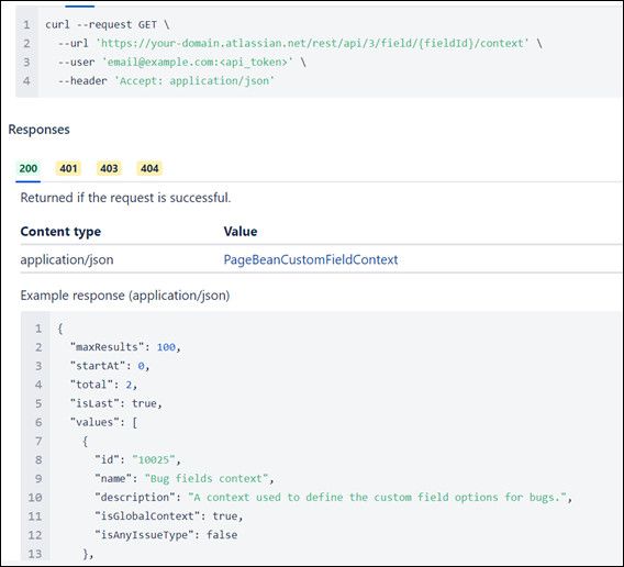

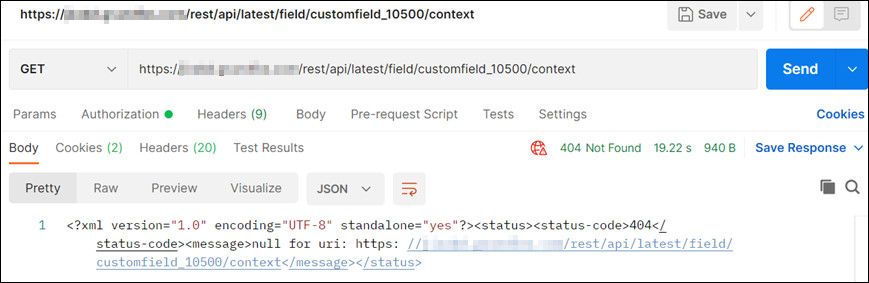

It is my understanding that it should be possible to query the customfields by this direct API call:
.. but if I do this, then I get this 404 error:
Can anyone help me solving this problem? :-) I would really hate hardcoding these IDs in my code.

Above code is for getting custom field context, one custom field have multiple context, jira admin create separate context for each project in which a custom field is used. This don't give the value of a custom field for an issue.

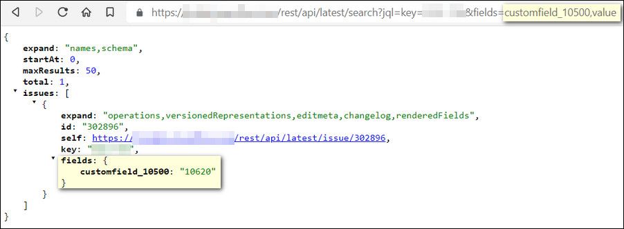

Dan Hansen
June 10, 2022

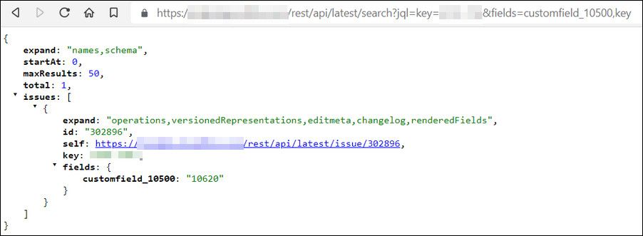

This is the 3rd time I am replying here - it seems my replies are not saved?
This URL, "https://jira.xyz.com/rest/api/latest/search?jql=key=PRO21&fields=customfield_10500,key'" does not give the real value for the customfield - it merely limits the dataset and displays the exact same data (ID only) and does not expand its name value.

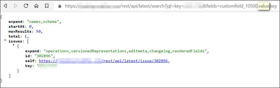

I don't work with APIs much, but can you add .value to the end of the field?
customfield_10500.value

Dan Hansen
June 10, 2022
@John Funk - it looks like this without the value part - the customfield ID is visible but not the value:
But with the ".value" in the URL then it removes the customfield:

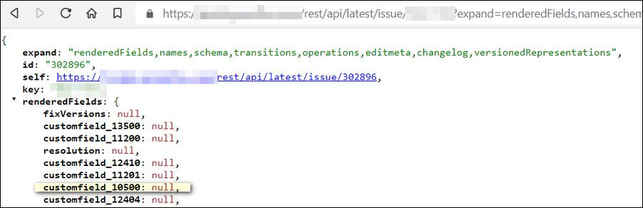

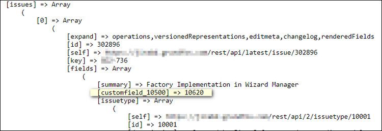

@Fabio Racobaldo _Catworkx_ - I am already using this and it shows the output as within my original post. To show the entire thing then it is here (I have cut away some of the unnecessary stuff):
URL which will include all data scope (as I know it at least): https://jira.xy.com/rest/api/latest/issue/KEY-736?expand=renderedFields,names,schema,transitions,operations,editmeta,changelog,versionedRepresentations
If I then search for customfield_10500 then I get these results:
If I search for the actual team name that I can see is set on the issue, then I find it only visible in the CHANGELOG dataset (because I have tested it with some changes).
So the data seems not visible not even with the complete dataset?

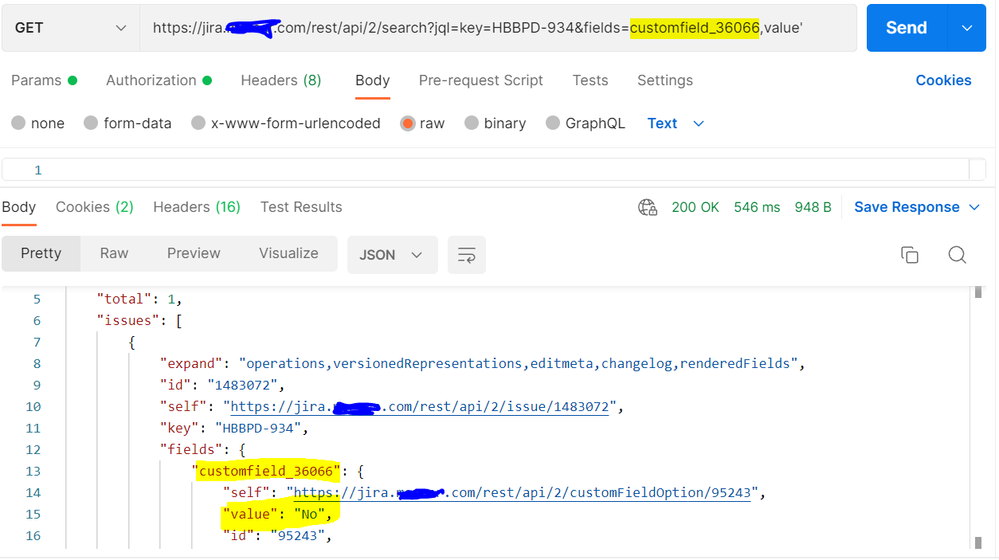

@Dan Hansen  I tested in postman following GET command and get custom field value selected for an issue, as you can see in the screenshot. I think you are looking for the same.
You can convert json result in csv or excel to see correct format or use Power query to fetch data in excel directly from jira.
https://jira.xyz.com/rest/api/2/search?jql=key=HBBPD-934&fields=customfield_36066,value'

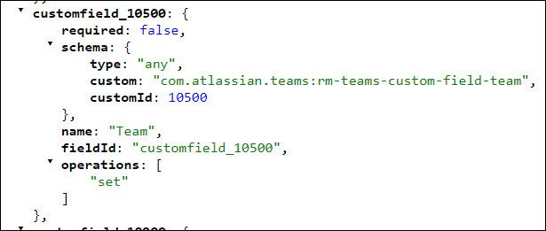

Vikrant Yadav
June 10, 2022

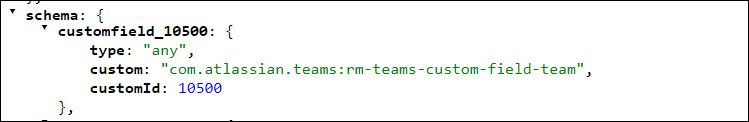

@Dan Hansen  As per the screenshots shared by you and after checking the field type ( com.atlassian.teams:rm-teams-custom-field-teams ) , it seems that it's Advanced Roadmap "Team" field. Please correct me if I am wrong.
If it's Roadmap "Team" field, kindly check workaround shared in following link :-  I would like to have a rest API call that returns the issues' details with their respective Portfolio Teams name.
Thanks
Dan Hansen
June 12, 2022
@Vikrant Yadav - yes, good spotted that we are using the JIRA Advanced Roadmap feature. I did not know the Team customfield was special for this?

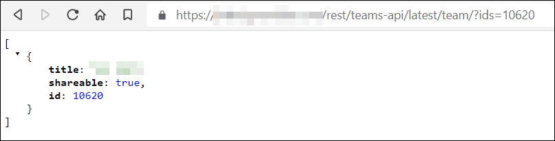

Hi @Dan Hansen  Kindly check following link for Advance Roadmap API :-
https://docs.atlassian.com/portfolio-for-jira-server/REST/2.13.0/teams/
This is Roadmap Team field, that's why not accessible like other Custom Field.
Thanks
V.Y
Dan Hansen
June 13, 2022
@Vikrant Yadav - great and this works (the blurred part is the actual team name)! :-)
