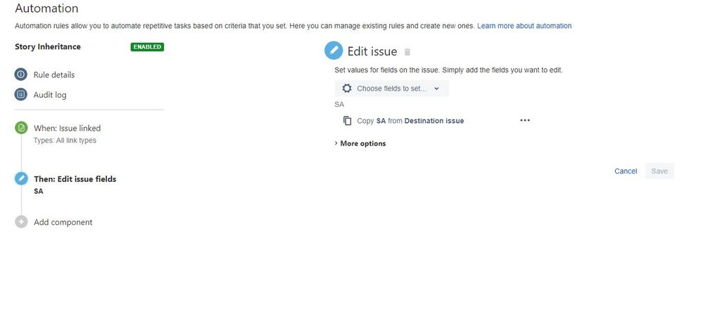

Samuel Gatica _ServiceRocket_
February 2, 2023
Hi @Mohamed Saad Taha
You can use the Jira Automation plugin, here is an example
Best regards
Sam

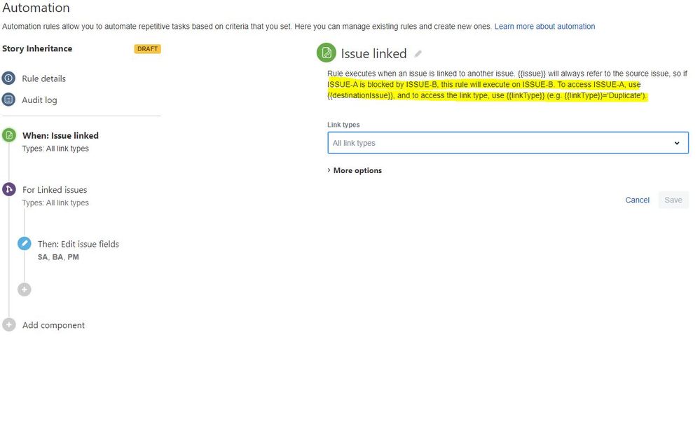

Mohamed Saad Taha
February 6, 2023
@Samuel Gatica _ServiceRocket_
 I create the rule below but it execute the action over issue B and I need to copy from issue B to Issue A
and blow is mentioned in the rule and I don't know where I configure this
Rule executes when an issue is linked to another issue. {{issue}} will always refer to the source issue, so if ISSUE-A is blocked by ISSUE-B, this rule will execute on ISSUE-B. To access ISSUE-A, use {{destinationIssue}}, and to access the link type, use {{linkType}} (e.g. {{linkType}}='Duplicate').
my Rule is below

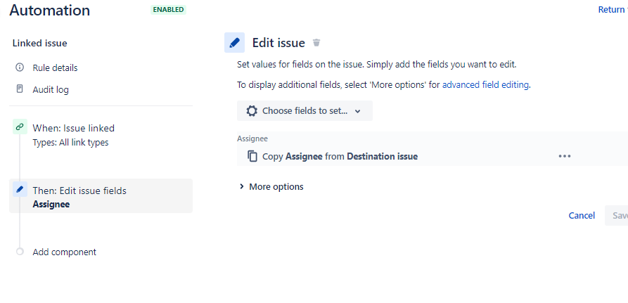

February 6, 2023
You need to remove the Branched condition and only use the Edit action and copy from the destination, as detailed in the image uploaded in my first post.
Best regards
Sam
Mohamed Saad Taha
February 6, 2023
you are correct if I need to update the source issuse but what i need to do is to update the  destination
below is my configuration

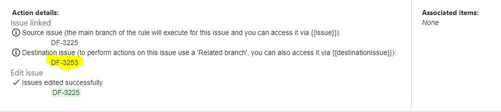

and below is the logg with show the the updated issue is the source
