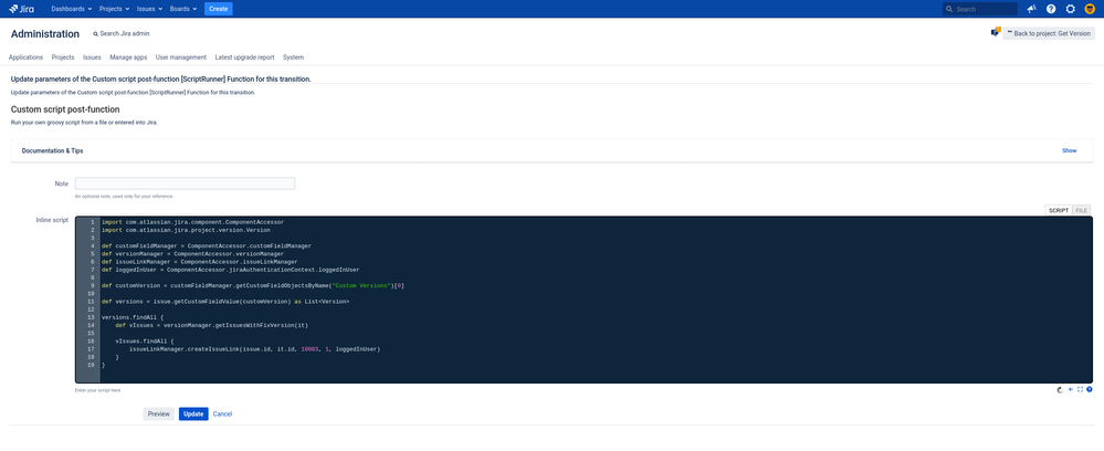

For this example, you will need to use the Custom script post-function
Below is a print screen of the Post-Function configuration.

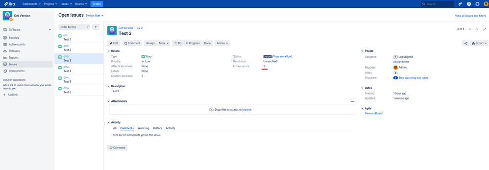

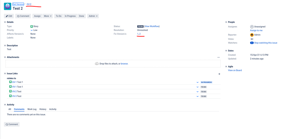

Below is an example test case:-

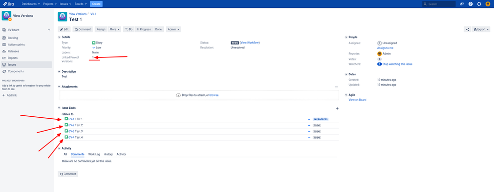

1) For the Issue I am going to transition, the value selected for the Versions field is 1 as shown in the print screen below:-

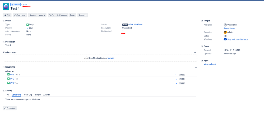

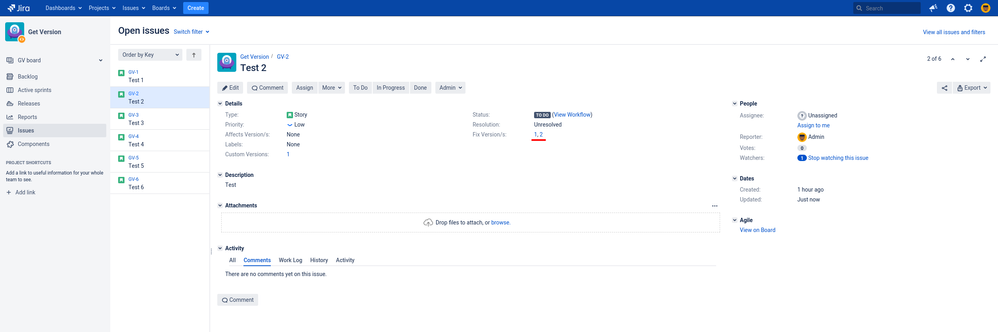

2) For the issues that are going to be linked with it, the Fixed Version/s selected is 1 as shown in the print screens below:-
Finally, once I try to transition the issue from To Do to In Progress, the issues will be linked as shown in the image below:-
I hope this helps to solve your question. :)

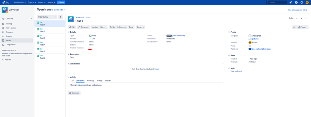

Hello @Ram Kumar Aravindakshan _Adaptavist_
Actually, let me describe you a little bit more...
We have two projects called A and B. so whenever we are creating the Change in project B we want to select the fix versions of project A and then linked the tickets of this selected fix version of project A to the Change of project B as relates to.
So I have created a custom field called "Versions" and using script runner rest endpoint fetching all the fix versions of project A to this Versions field.
Once i made the changes to my custom script pf as per your code and getting the below error. also, the selected fix version is return as j i r a - s o f t w a r e instead of jira-software.

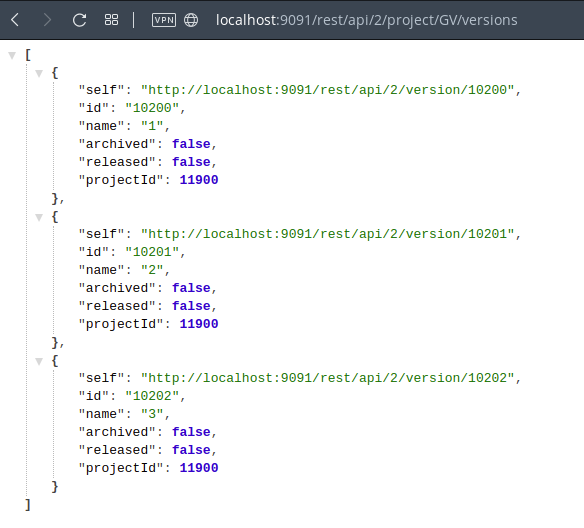

For your requirement, you will need to do work with a couple of components, i.e. REST Endpoint, Behaviour and Listener.
The URL you will need to access is <JIRA HOME>/rest/api/2/project/${projectKey}/versions.
In the example below, the URL used is http://localhost:9091/rest/api/2/project/GV/versions and GV is the project key.
Before using the REST Endpoint to filter the fields, below is a sample output you should receive:-
1) First, to get the list of versions from another project using the URL shown above, you will need to use the REST Endpoint.
Please note, the sample codes shared here are not 100% exact to your environment. Hence, you will need to make the required modifications.

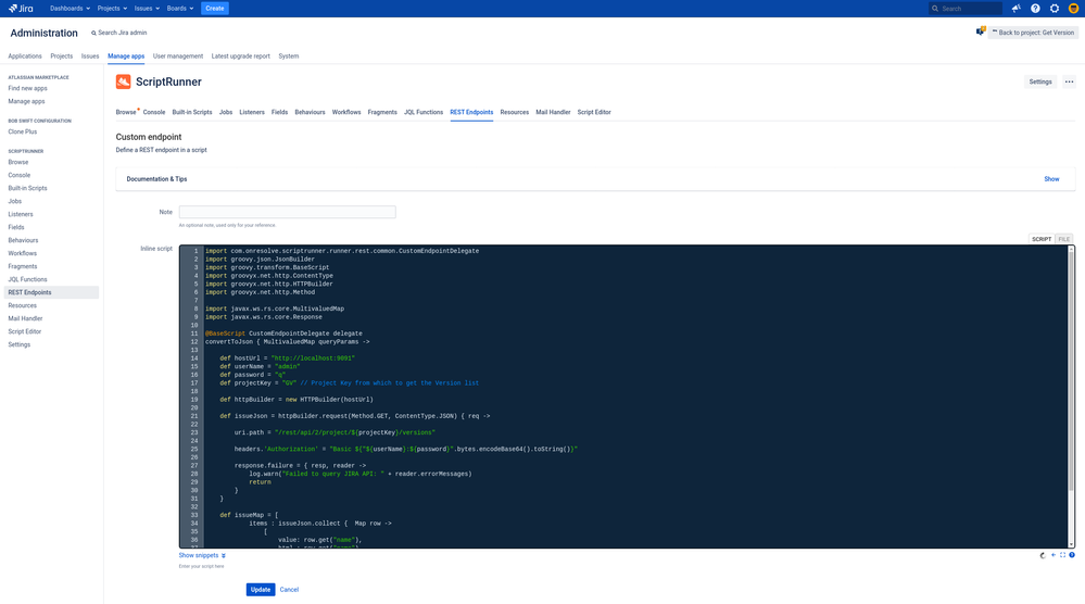

Below is a sample code for your reference:-
import com.onresolve.scriptrunner.runner.rest.common.CustomEndpointDelegate
import groovy.json.JsonBuilder
import groovy.transform.BaseScript
import groovyx.net.http.ContentType
import groovyx.net.http.HTTPBuilder
import groovyx.net.http.Method
import javax.ws.rs.core.MultivaluedMap
import javax.ws.rs.core.Response
@BaseScript CustomEndpointDelegate delegate
convertToJson { MultivaluedMap queryParams ->
def hostUrl = "http://localhost:9091"
def userName = "admin"
def password = "q"
def projectKey = "GV" // Project Key from which to get the Version list
def httpBuilder = new HTTPBuilder(hostUrl)
def issueJson = httpBuilder.request(Method.GET, ContentType.JSON) { req ->
uri.path = "/rest/api/2/project/${projectKey}/versions"
headers.'Authorization' = "Basic ${"${userName}:${password}".bytes.encodeBase64().toString()}"
response.failure = { resp, reader ->
log.warn("Failed to query JIRA API: " + reader.errorMessages)
return
def issueMap = [
items : issueJson.collect { Map row ->
value: row.get("name"),
html : row.get("name"),
label: row.get("name")
return Response.ok(new JsonBuilder(issueMap).toPrettyString()).build()
Below is a print screen of the REST Endpoint Configuration:-

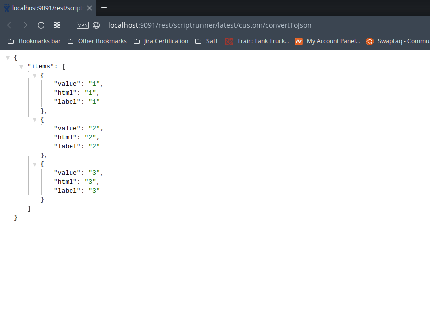

When you test the REST Endpoint, you should get something like this:-

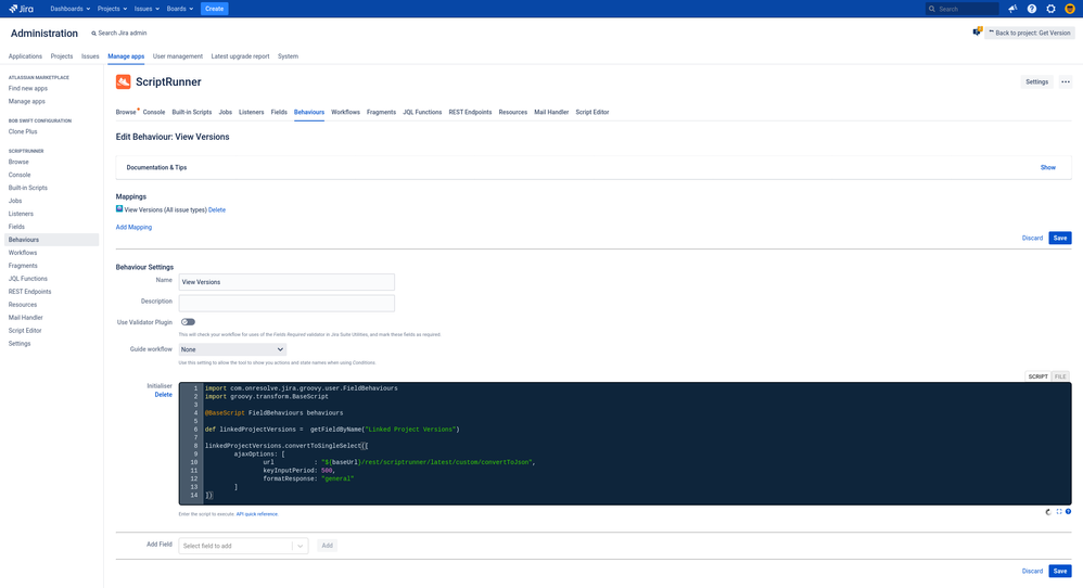

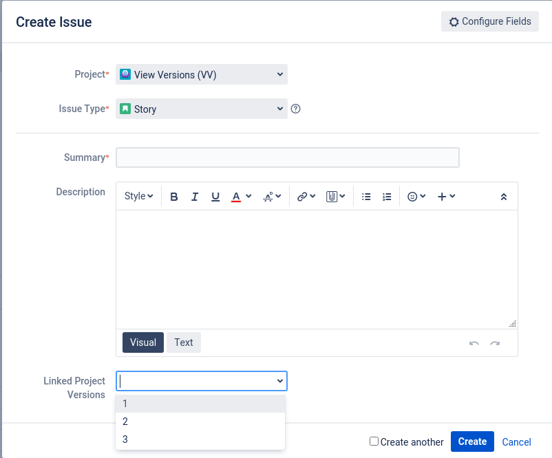

2) Second, you will need to use the Behaviour initialiser to convert a text field to a single select / multi-select and pass the output from the REST Endpoint to the field.
Below is a sample code for the Behaviour:-
import com.onresolve.jira.groovy.user.FieldBehaviours
@BaseScript FieldBehaviours behaviours
def linkedProjectVersions = getFieldByName("Linked Project Versions")
linkedProjectVersions.convertToSingleSelect([
ajaxOptions: [
url : "${baseUrl}/rest/scriptrunner/latest/custom/convertToJson",
keyInputPeriod: 500,
formatResponse: "general"
Below is a print screen of the Behaviour configuration:-
Below is a print screen of the Create dialog with the text field converted to single select:-
If you observe, you can see the list of version similar to the REST Endpoint result.

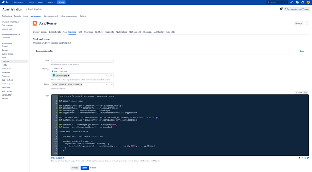

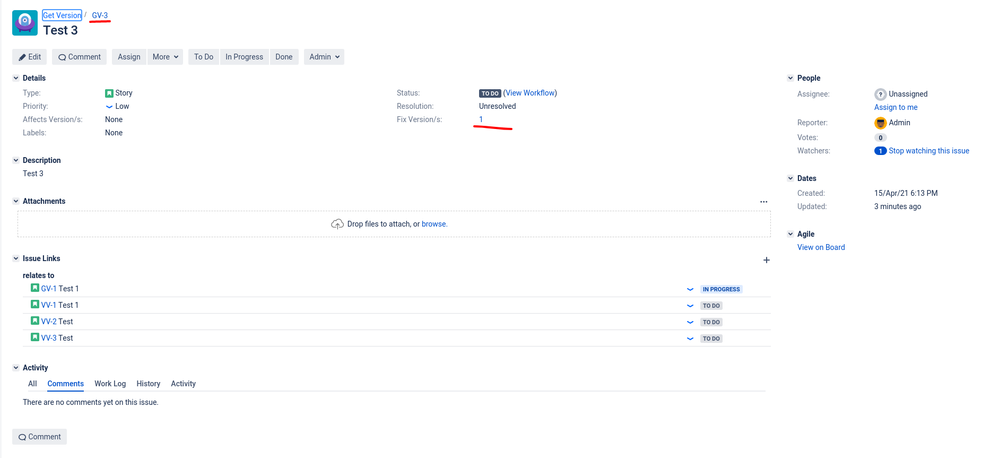

3) Finally, you will need to add a Listener to link the issues. In this example, I am using the Custom Listener with the Issue Created event and Issue Updated event.
Below is a sample code for the Listener:-
import com.atlassian.jira.component.ComponentAccessor
def issue = event.issue
def customFieldManager = ComponentAccessor.customFieldManager
def issueLinkManager = ComponentAccessor.issueLinkManager
def issueManager = ComponentAccessor.issueManager
def loggedInUser = ComponentAccessor.jiraAuthenticationContext.loggedInUser
def customVersion = customFieldManager.getCustomFieldObjectsByName("Linked Project Versions")[0]
def customVersionValue = issue.getCustomFieldValue(customVersion).toString()
def issueIds = issueManager.getIssueIdsForProject(11900)
def issues = issueManager.getIssueObjects(issueIds)
issues.each { sourceIssue ->
def versions = sourceIssue.fixVersions
versions.findAll {version ->
if(version.name == customVersionValue) {
issueLinkManager.createIssueLink(issue.id, sourceIssue.id, 10003, 1, loggedInUser)
In the Listener, you will need to modify this line of code according to your environment, i.e.
In my instance, the project id for the GV project is 11900. So you will need to modify it accordingly to match the id of the source project from which the versions are taken.
Below is a print screen of the listener configuration:-

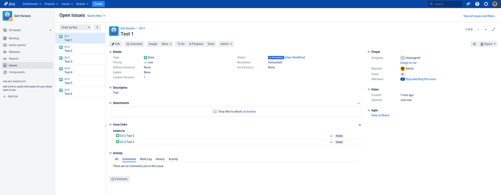

Once the ticket has been created, you should see the issues from the other projects which have the same version as the issue created linked to the issue as shown in the image below:-

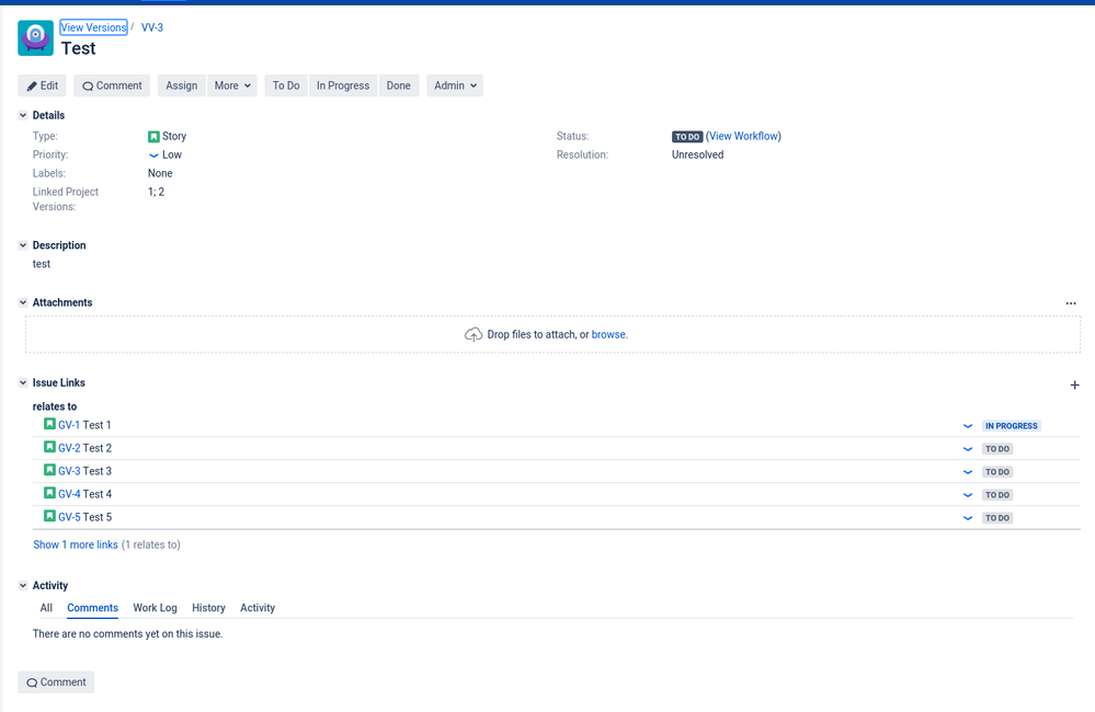

Thank you for your response.
Previously I was checking with workflow script post function and now checked with the listener, its working/linking issues to the current issue based on selected fix versions as expected but for single fix versions only. if I select the multiple versions then it's not working.
As you have shown above if I select the two versions like 1 and 2 in the "Linked Project Versions" field then it's not linking both the versions issue to the current one but if I select as 1 version then it's linking.
Thanks.

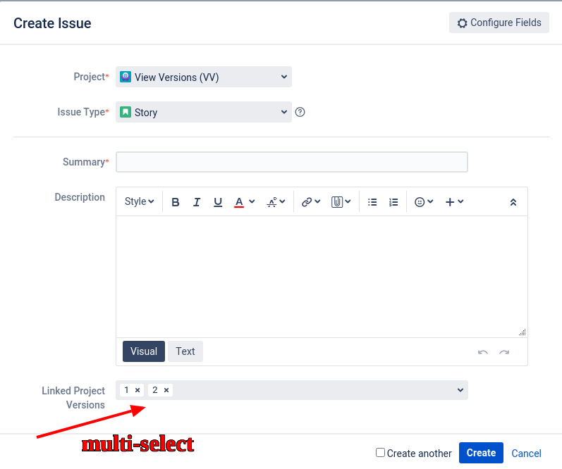

Hi @Yogesh Mude,
As I explicitly mentioned in my previous comment, I was using the single select example in the sample code that I shared. Hence, you are only able to make one selection at a time.
If you want to select multiple versions, you will need to modify the Behaviour code and the Listener code accordingly.
In the Behaviour, you will need to change from
linkedProjectVersions.convertToSingleSelectto
linkedProjectVersions.convertToMultiSelectThis will allow you to choose multiple versions.
Below is the sample code for your reference:-
linkedProjectVersions.convertToMultiSelect([
ajaxOptions: [
And for the Listener, you will need to modify the customVersionValue to output as a List instead of a String, i.e. from
to
def customVersionValue = issue.getCustomFieldValue(customVersion).toString() as List<String>
and also modify the if condition from
to
if(version.name in customVersionValue)
if(version.name in customVersionValue) {
Please note, the example codes are not 100% exact to your environment. Hence, you will need to modify them accordingly.
Below are a few print screen examples:-
Below are print screens of some of the linked issues
Thank you for your swift response.
I have changes the below code
To
if(customVersionValue.contains(version.name))
It worked fine. :)
