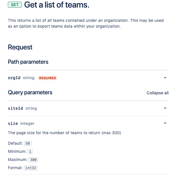

If you expand the parameters information for the API call found here:
https://developer.atlassian.com/platform/teams/rest/v1/api-group-teams-public-api/#api-public-teams-v1-org-orgid-teams-get
...you will see a size parameter. This specifies how many results will be returned. The minimum is 1 and the maximum is 300. The default value is 50.
To get more than 50 results you need to set this parameter as part of your API call.
Edxavier Roberto Caez (Optum)
April 30, 2025
Hi @Trudy P Claspill
Thanks for your reply. You said that I need to include the size parameters in the URL? Like this?
https://{{orgUrl}}/gateway/api/public/teams/v1/org/{{orgId}}/teams?size=300
Trudy P Claspill
April 30, 2025
I haven't tried it, but yes, I think that is the correct syntax.
April 30, 2025
@Trudy P Claspill Thanks that worked.
This will be the final endpoint.
