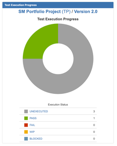

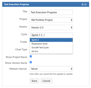

@[deleted],
It is possible using that gadget. You can filter the report to a particular cycle by selecting the project, version, and cycle name when you are configuring the gadget (see the images below).
 Screen Shot 2019-01-11 at 9.56.46 AM.pngScreen%20Shot%202019-01-11%20at%209.56.29%20AM_thumb.png
