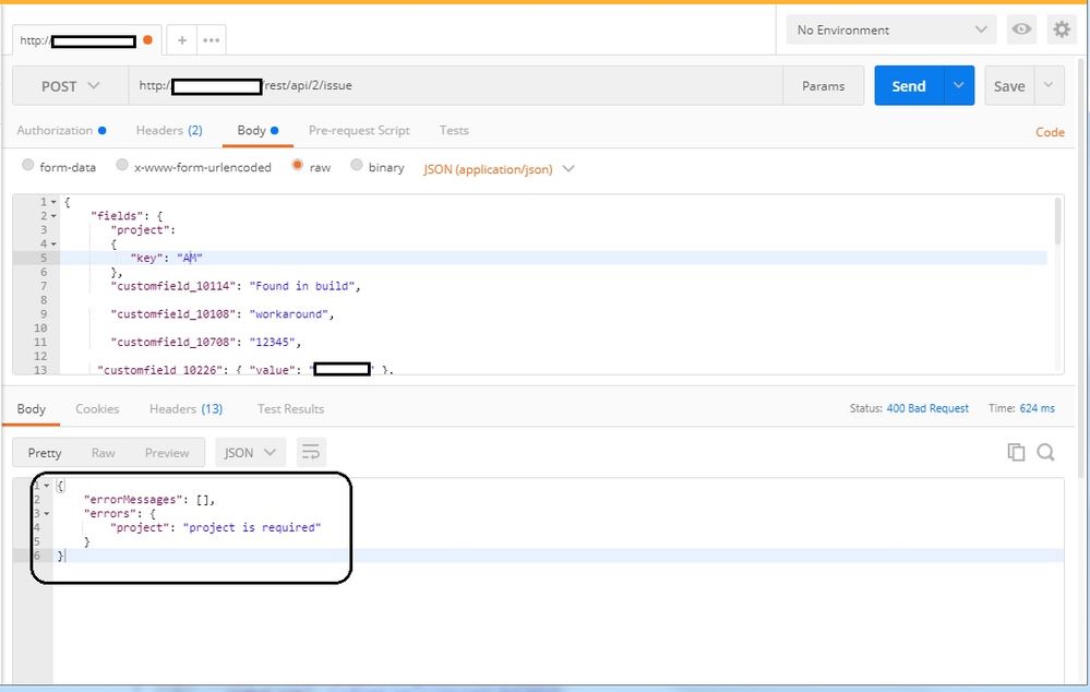

Maxim Makarovsky
March 13, 2018
ok...
when i am using the google postman it response me with the same message
see the attachment
how can i get this message in java call?
Nic Brough -Adaptavist-
March 13, 2018
Your JSON does not appear to be complete.  The first message in your original question tells you that.  The second error is probably a direct consequence - if the JSON is not complete, Jira doesn't know how to read it, so it discards it, and then tells you that it can't import data that it doesn't know about.
Maxim Makarovsky
March 13, 2018
any solutions?
March 13, 2018
Yes, send it complete JSON.
