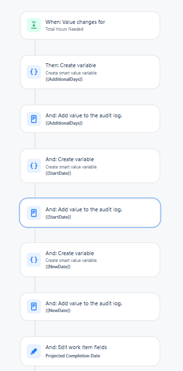

It would be helpful if you provided us with screen images that shows your entire rule. Sometimes these types of errors are related to the context of the step.

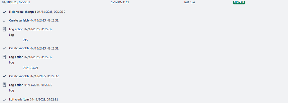

I have played around with your suggestions and Piyush's. Here is where the rule stands now, I used variables and log entries to determine where the issue is.
Thank you for that additional information.
When you create a variable, the information is stored as a string. So if you have a variable that is showing a date and try to use a date function with it, that won't work. You would be trying to apply a date function to a string; i.e.
{{StartDate.plusDays(AdditionalDays)}}
is interpreted as
<string value> plusDays <string value>
You have to cast the variable string values as the appropriate data type.
StartDate.toDate("<formatting of the StartDate value>")
i.e. if StartDate is 2025-04-18 then to cast that as an actual date to which you can apply other date manipulation functions:
StartDate.toDate("yyyy-MM-dd")
Then cast AdditionalDays as a number:
AdditionalDays.asNumber
And optionally apply a date formatting command at the end:
{{StartDate.toDate("yyyy-MM-dd").plusDays(AdditionalDays.asNumber).jiraDate}}
If your starting date is a reference to a field that is already a Date or Date/Time field, you don't need to use the toDate function nor the final date formatting function; i.e.
{{issue.Date Started.plusDays(AdditionalDays.asNumber)}}
