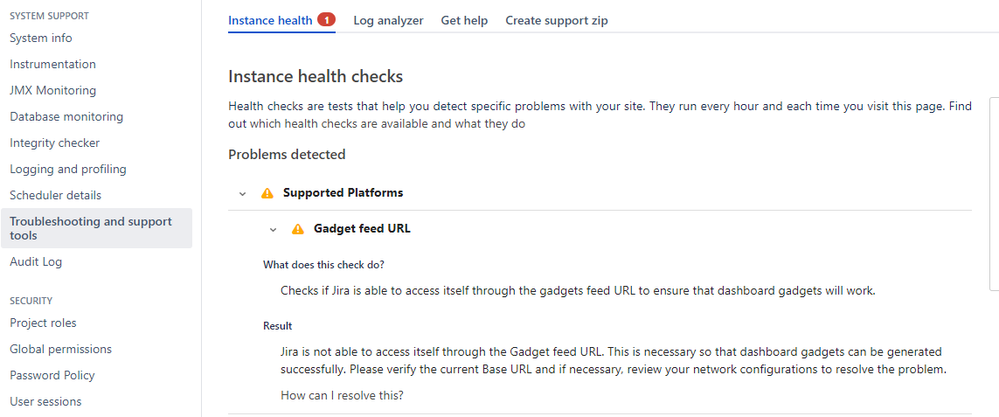

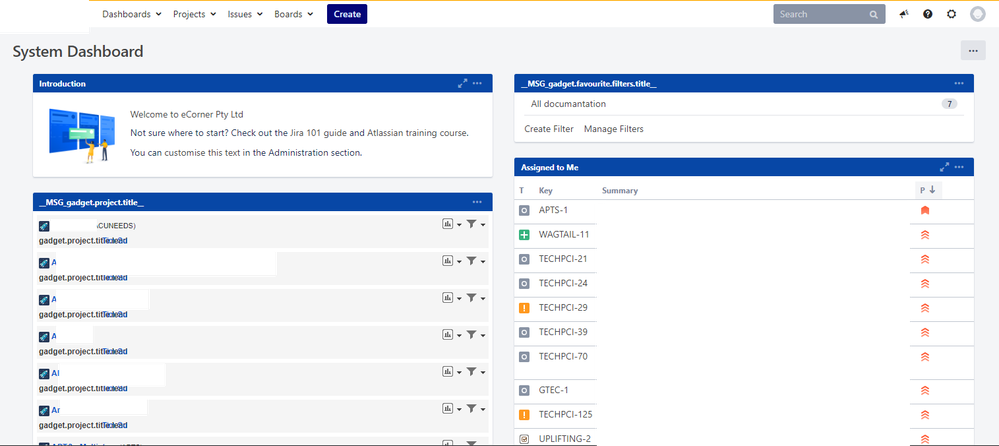

Hi,
We upgraded this week from 6.4 to 8.2.1 and then enabled SSL. For some reason some of the home page gadgets dont work now.

Hi,
I understand you upgraded Jira from a 6.4 version up to a 8.2 version and since that time the gadgets are not working correctly.   That's a very big upgrade jump to make. For the record we recommend that all Jira versions such as 6.4 and earlier first upgrade to a 7.0.x version before then upgrading to the latest versions.   There are a lot of significant changes in Jira 7.
That said, these two errors are very likely directly related.  Please see the KB How to fix gadget titles showing as __MSG_gadget.   This problem was very common to see for Jira sites starting with the 7.1.0 version of Jira. In this version Jira started to more strongly implement the requirement for the Jira application to be able to reach its own base URL address.  This is used as a means to optimize performance of dashboards and in turn it allows Jira to off-load some of the load to the clientside browser when rendering these gadgets.
That KB explains that there are lots of possible specific causes for this.  But all of them have a common theme: Jira can't reach its own address over your network.   I've seen that caused by routing rules for outbound traffic from the Jira Server itself, or SSL certificate issues.   I suggest trying the diagnosis steps in the KB to help narrow down the cause:
  • From the Jira server itself, Jira is unable to communicate with itself via its Base URL (Run curl -v <base_url> to verify)
  • Run SSLPoke from the Jira server itself and see if it returns successfully
  • Additionally run the httpclienttest from the Jira server itself to confirm if the SSL configuration is okay, as this will verify if you're affected by  JRASERVER-47568 - JIRA complains about SNI host Closed
The results of these steps should be able to help us narrow the focus here.
