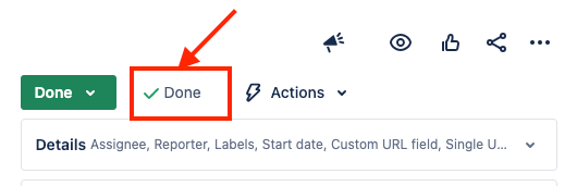

This issue is resolved.
<image>

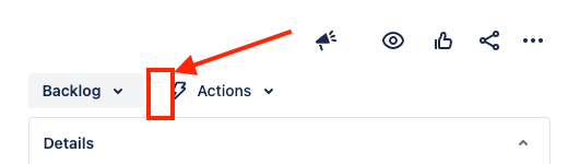

This issue is not resolved.
<image>
