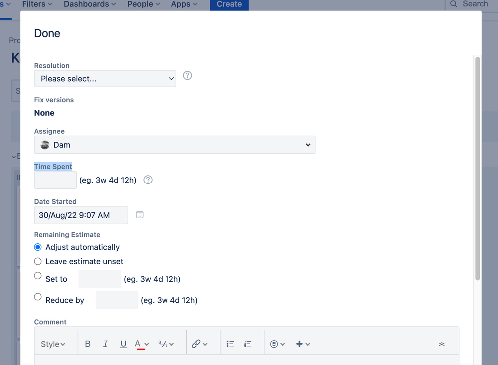

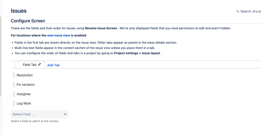

> I can't make the Time spent field mandatory because it doesn't appear on the screen until the Log work tickbox is ticked.
Well I dont see any tickbox if you use the field Log work on the screen...
Like in the default Resolve issue screen here.
Try with this field ;) It should work perfectly normally with a validator to make it mandatory...
I hope it helps a bit.
Dam.
Chu Dam
August 30, 2022
Hi @Andrew Dawson
Capture d’écran 2022-08-30 à 09.08.26.pngCapture d’écran 2022-08-30 à 09.08.57.png
Dam

Andrew Dawson
August 30, 2022
Hi @Chu Dam
Excellent, thanks! This looks like it solves the issue. The problem was that on the Resolve Issue Screen, we also had the "Time tracking" field showing, which meant that the "Log work" was a tickbox, which once ticked, showed the "Time Spent" field. Removing the "Time Tracking" field, now shows the "Time Spent" field by default, and that can be made mandatory to be changed.
