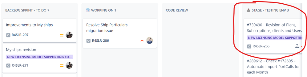

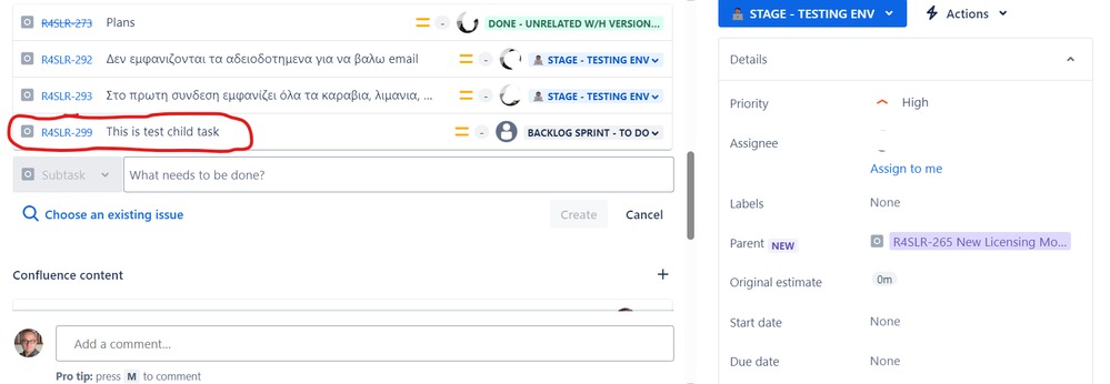

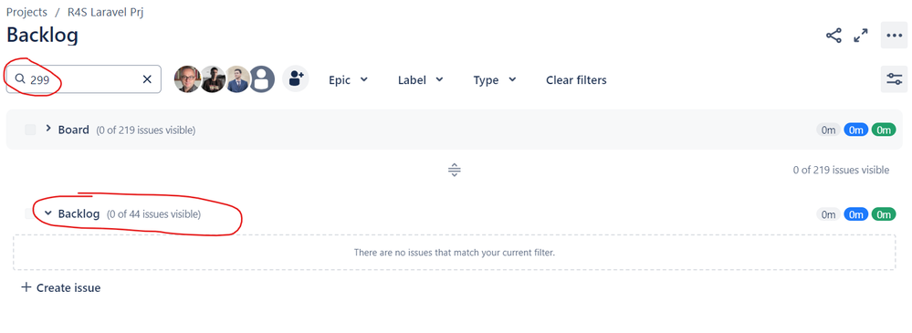

  1. From an issue located on the board, when I create a child issue then I cant retrieve/see it, into the Kanban board even into the backlog but I can see it into the parent issue and into the issues list
  2. when I create an issue always goes to the backlog even if I will primary assign it into a different working status.

#1 The only time you will see cards for Subtasks on the Board view is when you set the Group By option above the board to Subtasks, and the parent issue is on the Board. A change request about this exists here: https://jira.atlassian.com/browse/JSWCLOUD-18064
Likewise in the Backlog screen Subtasks don't display as separate items. Instead you will see an icon of a hierarchical structure on the line items for issues that have subtasks. You can only see the subtasks by viewing the issue.

If you use the Create button in the menu bar then the issue will be placed in the Backlog list for the Kanban board. For a Team Managed project Kanban board the display of the issue in the Backlog list or on the board is not based on the issue Status. An issue can be in any Status (other than a green/done status) and it can still display in the Backlog list. To have the issue moved to the board you need to do one of the following:
a. On the Backlog screen drag the issue from the Backlog list to the Board list that appears above the Backlog list
b. Create the issue by clicking on the +Create Issue at the bottom of the Board issue list at the top of the Backlog screen.
c. Create the issue by clicking on the +Create Issue option that appears at the bottom of the columns on the Board view.
