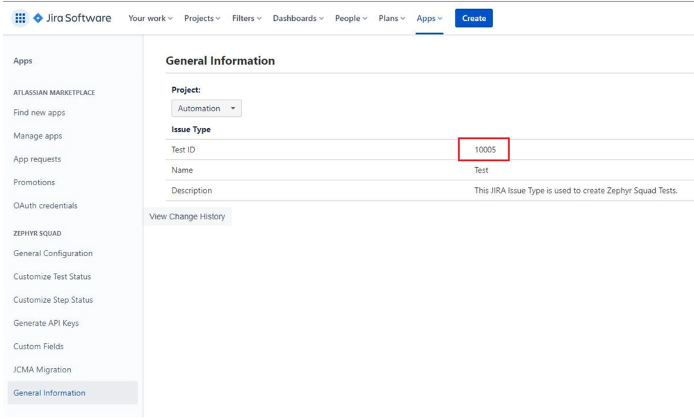

It may be the case that a wrongly attempted migration messed up the Test issue type configuration. Maybe try to uninstall the plugin, and make sure the Test issue type is also deleted. Then install the plugin back, and check Zephyr's General Configuration to see if the Issue Type ID linked there will match the Test issue type of your instance.
Other than that, we may need to have a closer look through support.
