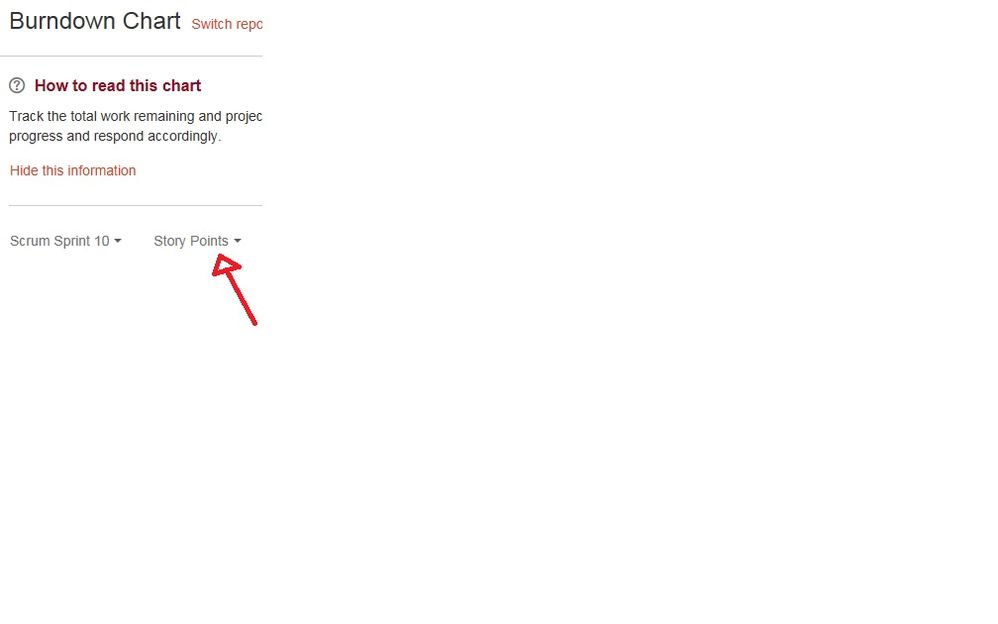

2) Some users are having issues  with showing "Remaining Time Estimate". We can see it as an active option on the list, but it won't select. Under Estimation for the board, "Original Time Estimate" was selected for Estimation Statistic, and "Remaining Estimate and Time Spent" was selected for Time Tracking.

For issue #2, when selecting "Remaining Estimate" from the list. We can select it, but then it doesn't "hold" it...it'll refer back to the option it had previously (eg. Story Point).  The board configured under Estimation  has "Original Time Estimate" was selected for Estimation Statistic, and "Remaining Estimate and Time Spent" was selected for Time Tracking. Did we miss anything in the configuration?

1) Yes, that's pretty much it - the right-hand column matters.
2) I don't understand what "it won't select" means.  The settings on the rest of it seem good, I just don't grasp the problem
