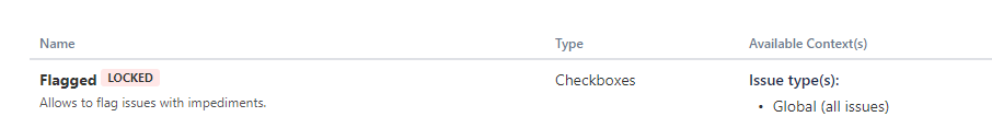

We are working with JIRA for quite a while now. And we also intensively use the flag option. For multiple of our projects this is working fine. Except for one. And we cannot figure out why this is the case. I checked this solution https://confluence.atlassian.com/jirakb/flagged-issues-do-not-get-marked-as-flagged-in-jira-agile-boards-781398730.html but I don't have an option to edit the flagged field since this one is locked.

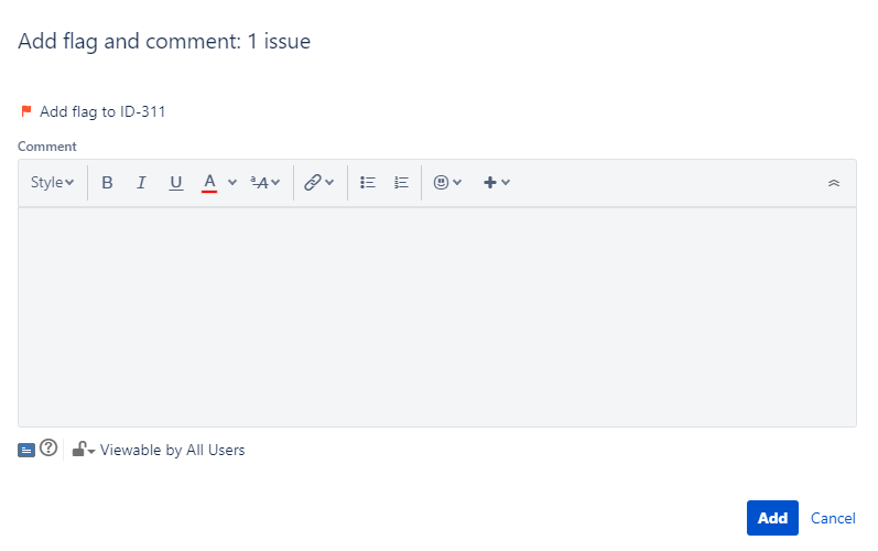

On this project I have the option to flag an item. Once I add a comment and click add the comment is added to the issue. But the issue is not flagged.

For the issue this doesn't matter. I try to flag the issue by right clicking on the board and select 'Add flag'

I’ve searched and tested here and it looks like the field is hidden on this project. I found a ticker on our support channel and the customer had the exact same issue and to fix this it’s necessary to unlock the field in the database to make it visible.
In order to access the database, it’s necessary to create a ticket with our support, so they can unlock this field, access the instance to make it visible and then lock the field again.
I see that you are not the site-admin of the instance, so you can’t create the ticket and also I can’t create the ticket on your behalf.
Please, talk to your site-admin to create the ticket and add you as a participant, so you can access and comment on the ticket.
