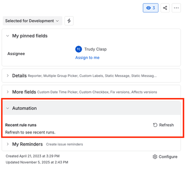

Do you have automation rules running that may be clearing the field? In the item details view you can expand and refresh the Automation panel to see automation rules that have recently been triggered by something in that issue.
Alternately you can go to the System > Global Automation > Audit Log to see the audit logs for all rules that have executed across the instance and review those for around the time you tried to set the Fix Version/s field to see if one of those cleared the field.
Have you checked the Details, More Fields, and Pinned Fields panels shown above the Automation panel?
