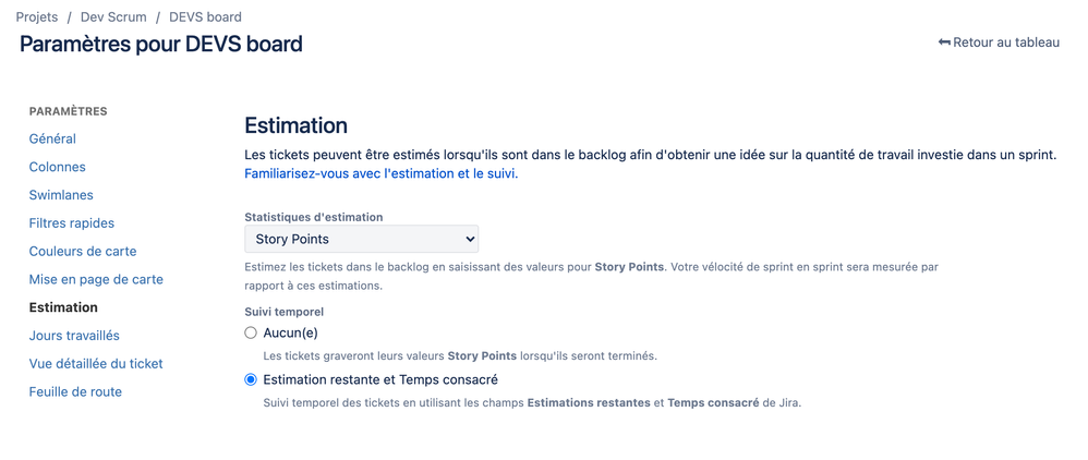

Indeed that's a though one, you can try using the "Burndown Chart" gadget from a dashboard;
Then, you would have to go to your board settings, in the "Estimation" parameters and select the "Remaining estimate and ... " option :
Then your burndown chart should decrease depending on the remaining estimate, hence you'll be able to know the total remaining estimate of the sprint i guess.
Let me know how it goes,
Guilhem

I tried what you suggested, and I can now see the total Remaining Estimate for the sprint in the Sprint Burndown Gadget on my dashboard.
I do wish there was alternative ways to get this information, so that you wouldn't have to "eyeball" it from a chart, as this exercise gets increasingly difficult if the scope of the sprint is changed when the sprint is active.

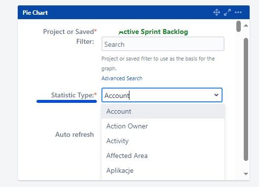

Rashmi Ratnani
June 3, 2024
Hi again @Claus Østergaard Pedersen
I am not sure if I missed anything.
I am unable to find the "estimate" fields in the statistic type dropdown.
Which fields should I be looking for?
Thanks.
June 3, 2024
Hi @Rashmi Ratnani
From your screenshot I can see that you are working on Jira Data Center and that you are using the gadget called "Pie Chart" not "Workload Pie Chart".
Apparently, the "Workload Pie Chart" is no longer available in Jira Data Center: https://community.atlassian.com/t5/Jira-questions/Where-is-workload-pie-chart-report/qaq-p/1066469
I thought you were using Jira Cloud, where the "Workload Pie Chart" is still available.
So unfortunately you are not able to use the functionality described earlier.
