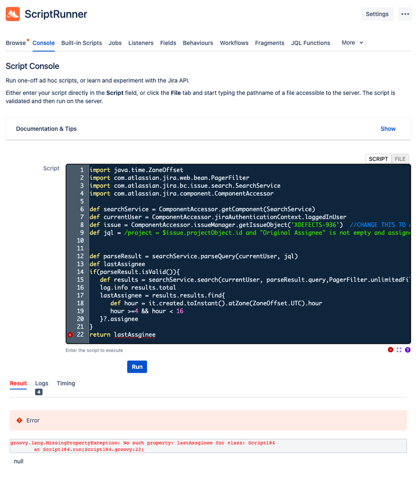

Also I tried running the snippet through console, but doesn't seem to work, stating that lastAssignee has to be declared:
Looks like there was a typo in my snippet.
The last line reads lastAssiginee and should be lastAssignee (it should match what's on line 13 and 17)
Try to run that in the console again and see if you get the correct user.

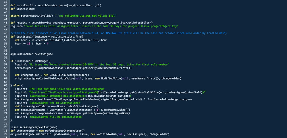

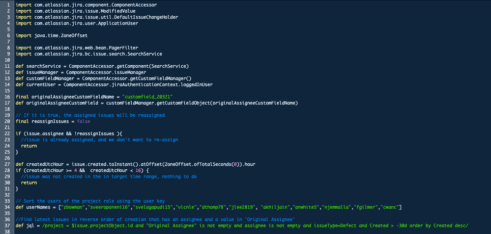

Here is how I would incorporate that JQL snippet into your whole script
import com.atlassian.jira.component.ComponentAccessor
import com.atlassian.jira.issue.ModifiedValue
import com.atlassian.jira.issue.util.DefaultIssueChangeHolder
import com.atlassian.jira.security.roles.ProjectRoleManager
import java.time.ZoneOffset
import com.atlassian.jira.web.bean.PagerFilter
import com.atlassian.jira.bc.issue.search.SearchService
def searchService = ComponentAccessor.getComponent(SearchService)
def issueManager = ComponentAccessor.issueManager
def projectRoleManager = ComponentAccessor.getComponent(ProjectRoleManager)
def customFieldManager = ComponentAccessor.getCustomFieldManager()
def currentUser = ComponentAccessor.jiraAuthenticationContext.loggedInUser
// The role you want assignees to set from
final roleName = 'Operations'
final originalAssigneeCustomFieldName = "customfield_20321"
def originalAssigneeCustomField = customFieldManager.getCustomFieldObject(originalAssigneeCustomFieldName)
// If it is true, the assigned issues will be reassigned
final reassignIssues = false
if (issue.assignee && !reassignIssues ){
//issue is already assigned, and we don't want to re-assign
return
def createdUtcHour = issue.created.toInstant().atOffset( ZoneOffset.ofTotalSeconds(0)).hour
if (createdUtcHour <= 4 || createdUtcHour >= 16) {
//issue was not created in the in target time range, nothing to do
return
// Get all of the users associated with the specified project role
def projectRole = projectRoleManager.getProjectRole(roleName)
// Sort the users of the project role using the user key
def users = projectRoleManager.getProjectRoleActors(projectRole, issue.projectObject)
.applicationUsers
.toSorted { it.key }
// There are no users in the specific project role
if (!users) {
log.info ("No users for project role $roleName")
return
//get recent issues in reverse order of creation
def jql = /project = $issue.projectObject.id and "Original Assignee" is not empty and assignee is not empty and issueType=Defect and Created > -30d order by Created desc/
def parseResult = searchService.parseQuery(currentUser, jql)
def lastAssignee
assert parseResult.isValid() : "The following JQL was not valid: $jql"
def results = searchService.search(currentUser, parseResult.query,PagerFilter.unlimitedFilter)
log.info "Found $results.total assigned defects in the last 30 days for project $issue.projectObject.key"
//find the first isstance of an issue created between 4-16 UTC (this will be the last one created since were order by Created desc)
def lastIssueInTimeRange = results.results.find{
def hour = it.created.toInstant().atZone(ZoneOffset.UTC).hour
hour >=4 && hour < 16

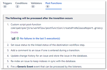

This will only run in a postfunction.
If you want to run the same thing in the console (for testing).

The reason you are getting the error is that you are mixing ApplicationUser entities with Strings of usernames.
So try to give you variable some names that indicate what they carry.
Like:
def userNames = ["user1","user2","user2","user3","user4","user5", "user6","user7","user8","user9","user10"]

We can address the static type checking error by importing the class ApplicationUser
import com.atlassian.jira.user.ApplicationUserThen declaring the nextAssginee using that class instead of def
ApplicationUser nextAssignee
This highlighted something that I missed... when no issues are returned in the jql, we must still convert the first user into an ApplicationUser object. I don't know why I thought this was already an ApplicationUser... probably leftover from when the list of users was coming from the role.
if(!lastIssueInTimeRange){
log.info "No issue was found created between 16-4UTC in the last 30 days. Using the first role member"
nextAssignee = ComponentAccessor.userManager.getUserByName(userNames.first())
} else {
log.info "The last assigned issue was $lastIssueInTimeRange"
log.info "$lastIssueInTimeRange has originalAssignee=${lastIssueInTimeRange.getCustomFieldValue(originalAssigneeCustomField)}"
log.info "$lastIssueInTimeRange has assignee=${lastIssueInTimeRange.assignee}"
lastAssignee = lastIssueInTimeRange.getCustomFieldValue(originalAssigneeCustomField) ?: lastIssueInTimeRange.assignee
log.info "lastAssignee set to $lastAssignee"
def lastAssigneeIndex = userNames.indexOf(lastAssignee)
def nextAssigneeName = userNames[(lastAssigneeIndex + 1) % userNames.size()]
nextAssignee = ComponentAccessor.userManager.getUserByName(nextAssigneeName)
log.info "nextAssignee will be $nextAssignee"
issue.setCustomFieldValue(originalAssigneeCustomField, nextAssignee)
issue.setAssignee(nextAssignee)
def changeHolder = new DefaultIssueChangeHolder()
originalAssigneeCustomField.updateValue(null, issue, new ModifiedValue(null, nextAssignee), changeHolder)
I added some logs to see what's happening.
I'm also noticing you don't have any code in there to persist the issue (after setting the assignee). The originalAssignee will be persisted with the updateValue, but not the issue.setAssginee.
I'd recommend using the following instead of your last 4 lines:
def issueService = ComponentAccessor.issueService
def input = issueService.newIssueInputParameters()
input.setAssigneeId(nextAssignee.key)
input.addCustomFieldValue(originalAssigneeCustomField.idAsLong, nextAssignee.key)
def validationResult = issueService.validateUpdate(currentUser, issue.id, input)
assert validationResult.isValid() : validationResult.errorCollection
issueService.update(currentUser, validationResult)
Hi @PD Sheehan ,
Sorry for the delay on my end, had a few high-priority items to handle. And once again, thank you for the continued support! Really appreciate it.
So I plugged in the above to handle nextAssignee as an applicationUser object, and also replaced the last four lines with the additional snippet to persist the issue as you suggested, and here's what I got now:

def userNames = ["userkey1","userkey2","userkey3","userkey4","userkey5", "userkey6","userkey7","userkey8","userkey9","userkey10", "userkey11"]
//Find latest issues in reverse order of creation that has an assignee and a value in 'Original Assignee'
def lastAssignee
log.info "Found $results.total assigned Defect issues in the last 30 days for project $issue.projectObject.key"
//find the first instance of an issue created between 16-4, or 4PM-4AM UTC (this will be the last one created since were order by Created desc)
hour >= 4 && hour < 16
} else {

Can you share a screenshot of your transition post function screen that shows where in the sequence this script is located?

No, I meant a screenshot like this one:

Here is a much-simplified version:
def customFieldManager = ComponentAccessor.customFieldManager
final originalAssigneeCustomFieldId = "customfield_20321"
def originalAssigneeCustomField = customFieldManager.getCustomFieldObject(originalAssigneeCustomFieldId)
return
if (createdUtcHour <= 4 && createdUtcHour >= 16) {
return
def lastAssigneeIndex = (ComponentAccessor.applicationProperties.getString('customRoundRobinIndex') ?: 0 ) as Integer
def nextAssigneeIndex = (lastAssigneeIndex + 1) % userNames.size()
ComponentAccessor.applicationProperties.setString('customRoundRobinIndex', nextAssigneeIndex.toString())
def nextAssignee = userNames[nextAssigneeIndex]
def nextAssigneeUser = ComponentAccessor.userManager.getUserByName(nextAssignee)
issue.setAssignee(nextAssigneeUser)
