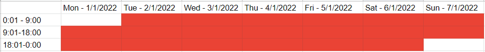

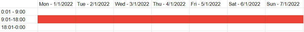

an cheil
March 1, 2022
Hi @Nir Haimov ,
Your solution will result to show data of all ticket in highlighted period as below screenshot: image.png
But Harsha is looking for something which only show all tickets which are created during below period.
Do you have any idea to achieve this goal?
