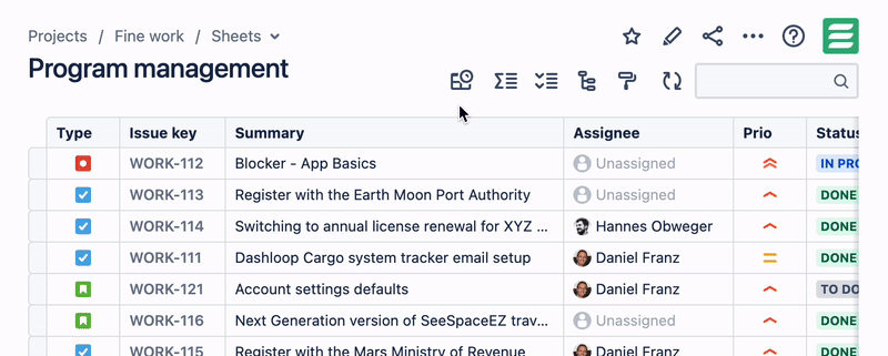

Just to expand on the last point, this is how this would look in the app that my team is working on, JXL for Jira; TLDR: You'd create a sheet with your relevant issues, enable the default hierarchy (that's just one click), and then use JXL's various filtering capabilities to narrow down your list of issues.
For the time being, you couldn't view all the relevant issues at the very same time (although this will be possible soon), but you could easily model both your points and switch between them, like so:
Once you have your list of issues, you can work on these directly in JXL (much like you'd do in e.g. Excel or Google Sheets), trigger various operations in Jira, or export them for further processing.
As said above, there may be other apps that help with this, too. You may already know that you can trial any app for free for 1 month, and depending on the size of your size, it may be free forever. So if an app is an option for your, perhaps try a few and see which works best for you!

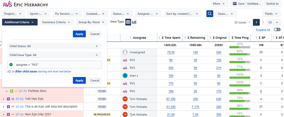

Hi @Seng Jin Hui
As mentioned by other community members, JQL may not help much for this use case.
If you are fine with a mktplace app to get this data, you can try out our add-on.
Issue Hierarchy Reports
The app will show your Epic hierarchy Links and also let your filter on the child issues using JQL.
Disclaimer : I work for the vendor who built this app
