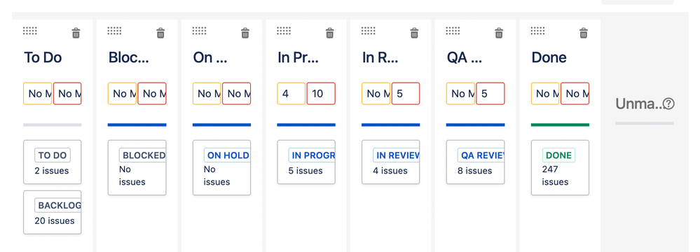

My status are correctly mapped out (see screenshot attached)
Screen Shot 2022-02-08 at 12.24.50 PM.pngScreen Shot 2022-02-08 at 12.25.47 PM.png
