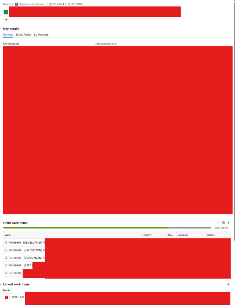

Is it possible to write a JQL filter or Scriptrunner that finds all RD tickets where the summary contains '[VALIDATION]', then returns the USRIM tickets they are blocking?
As in the example there's a child work item for Validation, I would want to know that it blocks USRIM-442 with a filter.Screenshot 2026-02-17 150259.png

In the example you provided it is the parent item that is blocking the USRIM item. The RD item that includes "VALIDATION" in the summary is a child of the item that is blocking USRIM.
Do you create a link directly between the child "VALIDATION" item and the blocked issue?
If you do not, then it appears what you need is
  1. Get the list of RD issues with "VALIDATION" in their Summaries
  2. Get the parent issues of #1
  3. Get the issues that are Blocked by #2 and are in the USRIM project
Is that correct? If so:
