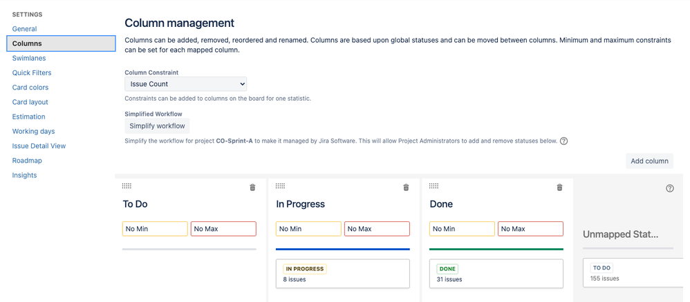

If you don't see any Inactive status issues on your board/backlog and you want to see them on your board/backlog, then you need to go to the Board configuration page for mapping Statuses to Columns. Any status that is not mapped to a column results in issues in that status not being displayed in either the Board view or the Backlog view.
This example is for a Company Managed project board. In this case all issues in the To Do status would be hidden from the backlog and board because To Do is in the Unmapped Statuses area.

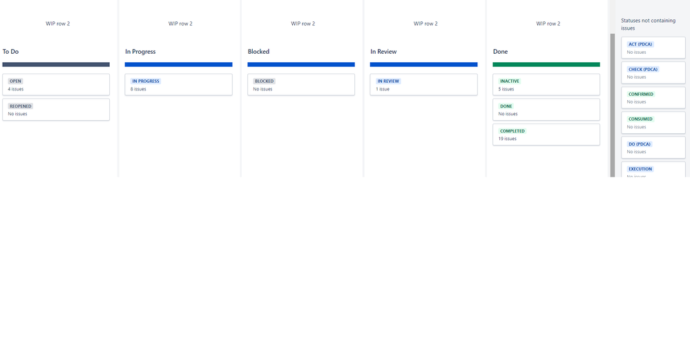

Here below the configuration of my columns:

Thank you for the screen image of your Columns. That was helpful.
Statuses are grouped into Status Categories globally. The Status Categories are
Issues in a status that is part of the Done Status Category will not be shown in the Backlog because, by definition, the work is "done". The Backlog shows only issues that are "not done". There is no reason to have "done" issues in the Backlog because there is no work to plan for them.
Your "Inactive" status has been set up as part of the Done Status Category. You can tell this because it is green. Therefore issues in the Inactive status will not display in the Backlog.

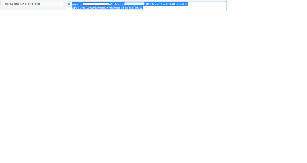

Here is the screenshots you requestedv (I deleted some names for confidentiality reasons):
Filter (it apperas in 2 lines because of the limited size of the coumn)

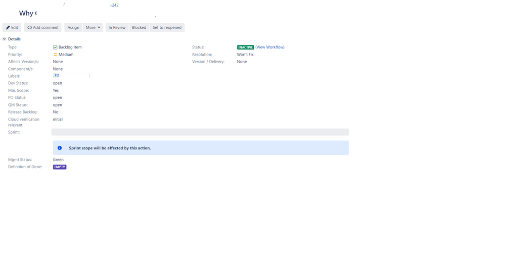

Issue that doesn'ha have a sprint number (Issue number 242):

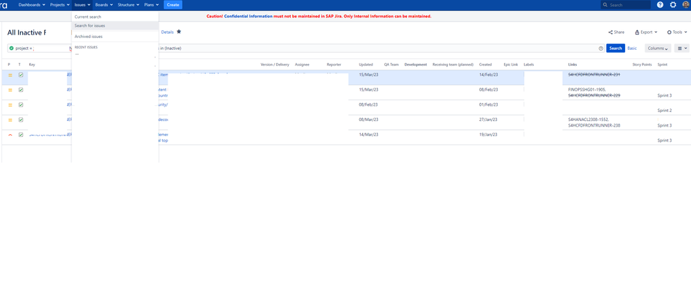

Result when applying the filter (we don't see the issue 242):

From the first image showing the filter it appears you are defining a Quick Filter in a board. Is that correct?
Is that Quick Filter being defined in a Scrum board or a Kanban board?
What is the Filter Query for this board? If it is a Kanban board, what is the Sub-filter for it?
Does this board have the same column/status mapping that you shared earlier?
Do you have any other Quick Filters activated on this board besides the "Inactive" filter?
If you use that same filter in the Advanced Issue Search screen, do you get the same results?

Since the specified issue (242) is in a "done" status and not in an Active sprint, it will not show on the Scrum board. Nor will it show on the Backlog screen for that Scrum board

Hi @Trudy P Claspill with your great guidance, I understood what is happening: I was tryning to get the list within a quick filter in the SCrum board which will only give me the list in the open sprint. The solution was that I create a global filer outside the board with the simple query:
project = XX AND labels = XX AND status in (Inactive)
Than I got all the list i,nclding the issue that was not assigned to a sprint:
