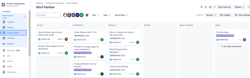

Example: Kanban Board Murf with board filter

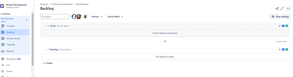

Example: Backlog Murf with board filter (empty)
All task in To Do from Kanban should be also in the Backlog.

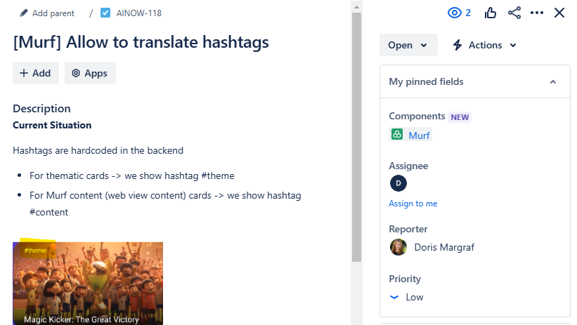

Here is an open task with the component selected
