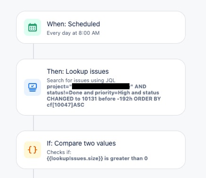

  • I'm trying to create a daily alert to Slack with a list of the Cases that have breached the SLA.
  • So, I want to filter out the reported cases that only have linked Bugs.
The current setup is as follows:

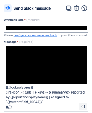

First I create a {{lookupIssues}}
I've tried different things to filter down to only the issues with linked Bugs, but I cannot get it to work. If I create a branch and drill down with if-statements, it (logically) still prints all the lookupIssues.
I've tried to do it with an #if-equals, but I can't seem to create the right smart value for the type of the linked issues:
{{#lookupIssues}}
{{#if(equals(issue.outwardIssue.fields.issue.Type, "10014"))}}
<{{url}} | {{key}} - {{summary}}> reported by {{reporter.displayname}}
