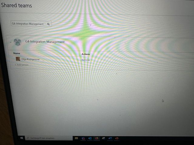

Thanks, that is exactly what I did. The example team is set up and I assigned a couple of users, including myself, to it and assigned all of them issues. I created a quick filter in the board as you mentioned but no issues appear when I click on it. I am sure I haven't selected any other filters so that can't be the reason. When I disable all filters, all issues appear in the board so they are definitely there.

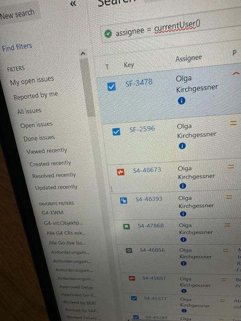

Yes, using the filter I also use for the board I can see all the issues I expect. However, no issues appear when I use the quick filter for the specific team.
Can you use the same filter on issue search?
open search -> change to advanced -> use same JQL which you used?
you able to see any issues?

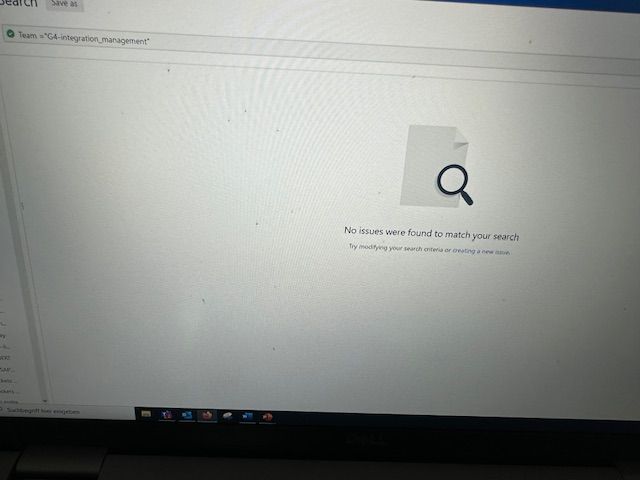

Without the team filter, yes. As soon as I add the team filter to the query, I can‘t see any issues in the issue search . So this might not be a board problem but a general one.

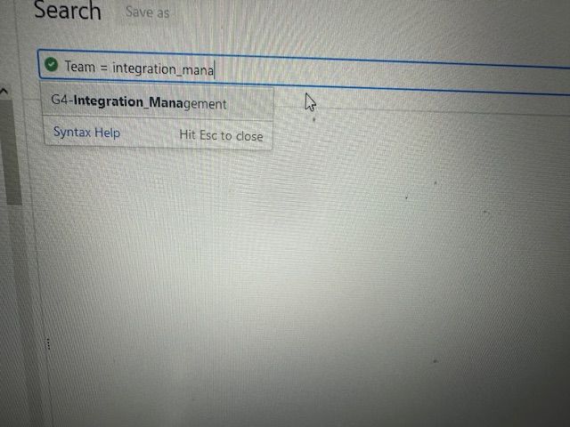

I think those issues are without team's name in team's field.
Can you check whether listed issues have the field Team, and it's updated with the team's name "G4-Integration_Management". Like mention in this image?
because when we don't assign the team's values in issues, but we still get assigned to ourselves, the JQL will work with
assignee=currentUser()
but won't work with
Team = G4-Integration_Management AND assignee=currentUser()
to complete your requirement, the team field has to be updated with the right team's name in issues.
let me know once you tried, and if it's working!!
