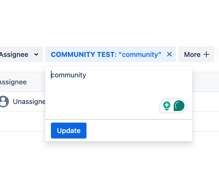

hello Team,
I did a quick check on my instance and it works fine
project = "AC" AND "community test[short text]" ~ "community" ORDER BY created DESC
It allows me to change the it basic and JQL mode
Could you please create a ticket here or let me know if you have already create a ticket here https://support.atlassian.com/contact/#/
This would help to further gain access and check
