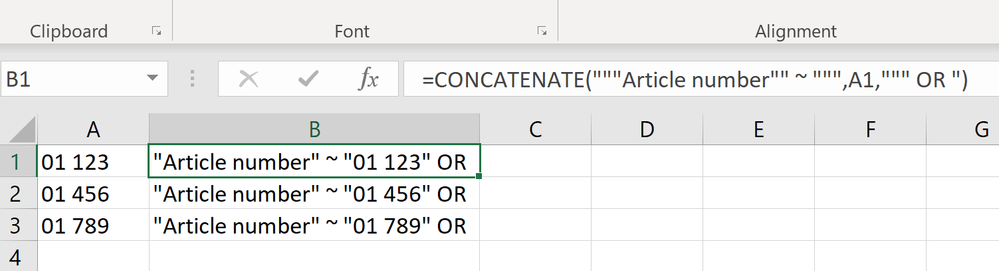

Glad it helped, Seb! You could utilize a tool outside of Jira, such as a text editor or Excel, for constructing your JQL. For example, if you had a column of article numbers in Excel, you could then in the next column use a function like this:
=CONCATENATE("""Article number"" ~ """,A1,""" OR ")
Copy and paste it down the column, and then copy that column's values and paste it into your JQL query (remove the final "OR").
