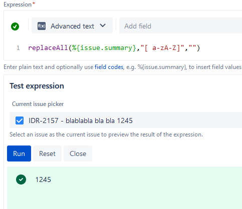

Hi @Patrik Klein
I think a plugin like JWT can potentially get you there depending on your use case.
from your example above, this function replaces a specific regex with nothing, so taking out all characters and spaces will leave you with the number which you can then assign to whatever field you like.
And with JWT you can do a condition on the function to only run when a specific thing occurs, in your example, if the summary has "blablabla"

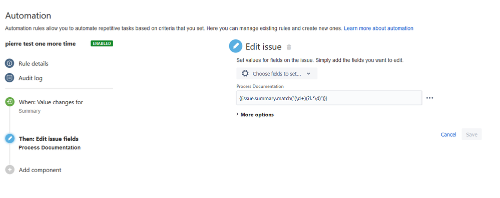

Pierre Ibrahim
February 1, 2024
I have a different solution for you that I was able to try successfully in my test environment
The regex reads: {{issue.summary.match("(\d+)(?!.*\d)")}}
basically only get the last digits in a string where there are no non digit characters, so it wouldn't get digits in the middle of the string, just at the end.
This worked great in my test environment, have it on issue create for the value changing and you'll be good to go!
Credit to: https://stackoverflow.com/questions/5320525/regular-expression-to-match-last-number-in-a-string
Hope that helps!
