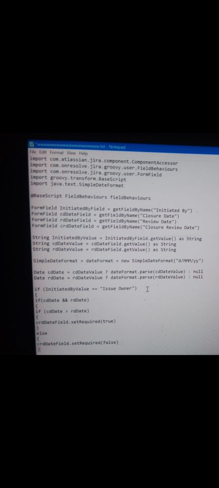

Devi Gattu
August 19, 2024
Hi @Hauke Bruno Wollentin
Thanks for the quick reply,
I am sharing the code here, please check
August 19, 2024
Where did you place this code? You aren't using ScriptRunner Behaviours aren't you?
Also: anything in the logs? You also could try to add some debug logging in your if-statements to check if conditions are true or not.
Devi Gattu
August 19, 2024
Hi ,
I have placed in script runner behaviour and I added debug log also so after the execution, it shows "no logs found in this execution".
August 19, 2024
Another guess, do you use custom field translation? We ran into this and _thought_ that the custom field name will be the same for Behaviours. But in fact it is the translation based on the configured language of a user 😅
This is our solution so far:
switch (usersLocale) {
case "de_DE":
fieldName = "Beschreibung"
break
case "it_IT":
fieldName = "Descrizione"
break
default:
fieldName = "Description"
def field = getFieldByName(fieldName)
 While "usersLocale" comes from com.atlassian.jira.user.UserLocaleStore
Also I'm not sure about the "@BaseScript" decorator you are using. I can't find this in the documentation, also we aren't using it as well.
But in general your script _should_ work
