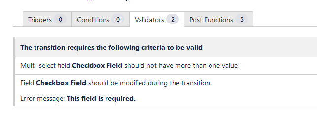

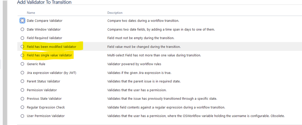

@Lina Abu-BakerI believe you can accomplish this using two validators.
  • Field has been modified Validator
  • Field has single value Validator
The first you will set that the "Checkbox field" must be modified, and the second validator will garantee that the field has only one option checked.
If the default value is "No", then will need unselect the value "No" and check the value "Yes".

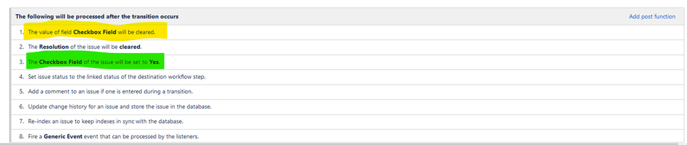

Why you do not use a post function to set the value of field ?
Lina Abu-Baker
September 8, 2021
@Carlos Faddul If I use a post function, would I need to create a custom script?
Carlos Faddul
September 8, 2021
@Lina Abu-Baker  no need for custom script :)
The configuration of post function it's very easy.
But you need to set correctly the post functions
First the mark yellow → you will clear any values in the custom field check box (because this is a multiple options field)
Second the mark green → you will set the value to "Yes" (or anything other value that you want)
I just recorded this video to help you with the post functions (need to order correctly they)
https://youtu.be/8qXQmuzEt-Q
You only need to order correctly the post functions in order, to they executed to do what you want.
