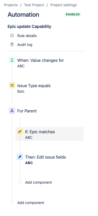

We have an issue type hierarchy of Capability > Epic > Story.
When all Epics under the Capability have a field set to True, I'd like that to update the same field in the Capability.
However, I can't work out how to do that with an automation rule? I can't seem to set it to recognise that the parent is Capability, and needs to be updated by a change to a field in all the Epics.
"ABC" in the attached screenshot is the name of the field.
Mark Segall
October 14, 2022
Hi @James Wardle - The Parent branch is misleading as it does not pertain to Advanced Roadmap hierarchy.  You'll want to do this:
  • TRIGGER: Field Value Changed (ABC)
  • BRANCH (JQL)
    • Key = {{issue.Parent Link}}
    • ACTION: Edit Issue (ABC)
James Wardle
October 14, 2022
Thanks @Mark SegallThat makes sense.
Do you know how I would set it so the Capability was only updated when all Epics have True in the ABC field?
