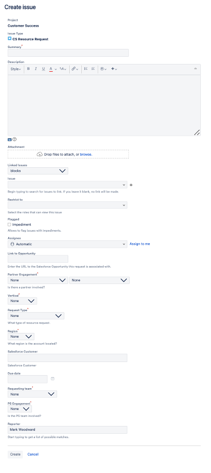

I have a custom issue type with specific fields in specific order/location.

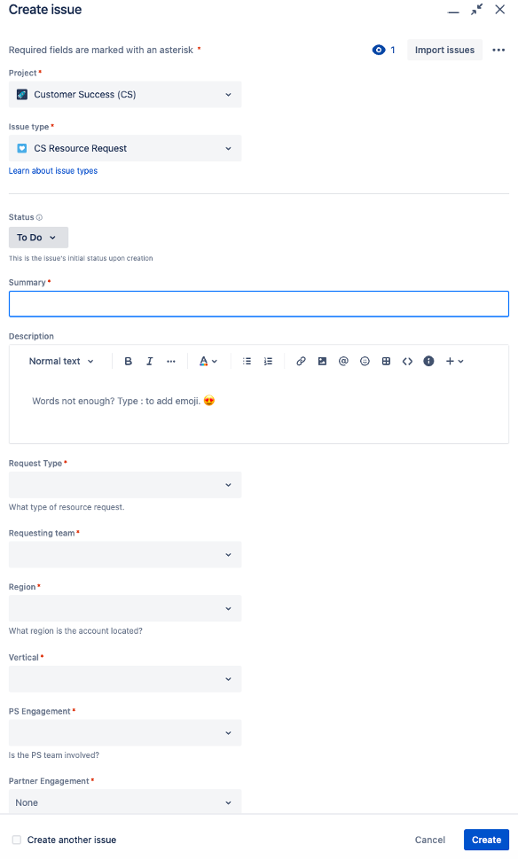

When I use Create button in the project the form displays as expected.
When I use a link https://blueconic.atlassian.net/secure/CreateIssue.jspa?pid=10042&issuetype=10086 to create an issue it uses correct project and issue type.
However, there are additional fields on the page (other standard Jira fields like Linked Issues, Issue, Restrict to, Flagged) that are not specified on the custom issue type.  Additionally, some of the fields that are specified on the custom issue type are displayed but in the wrong order/sequence.

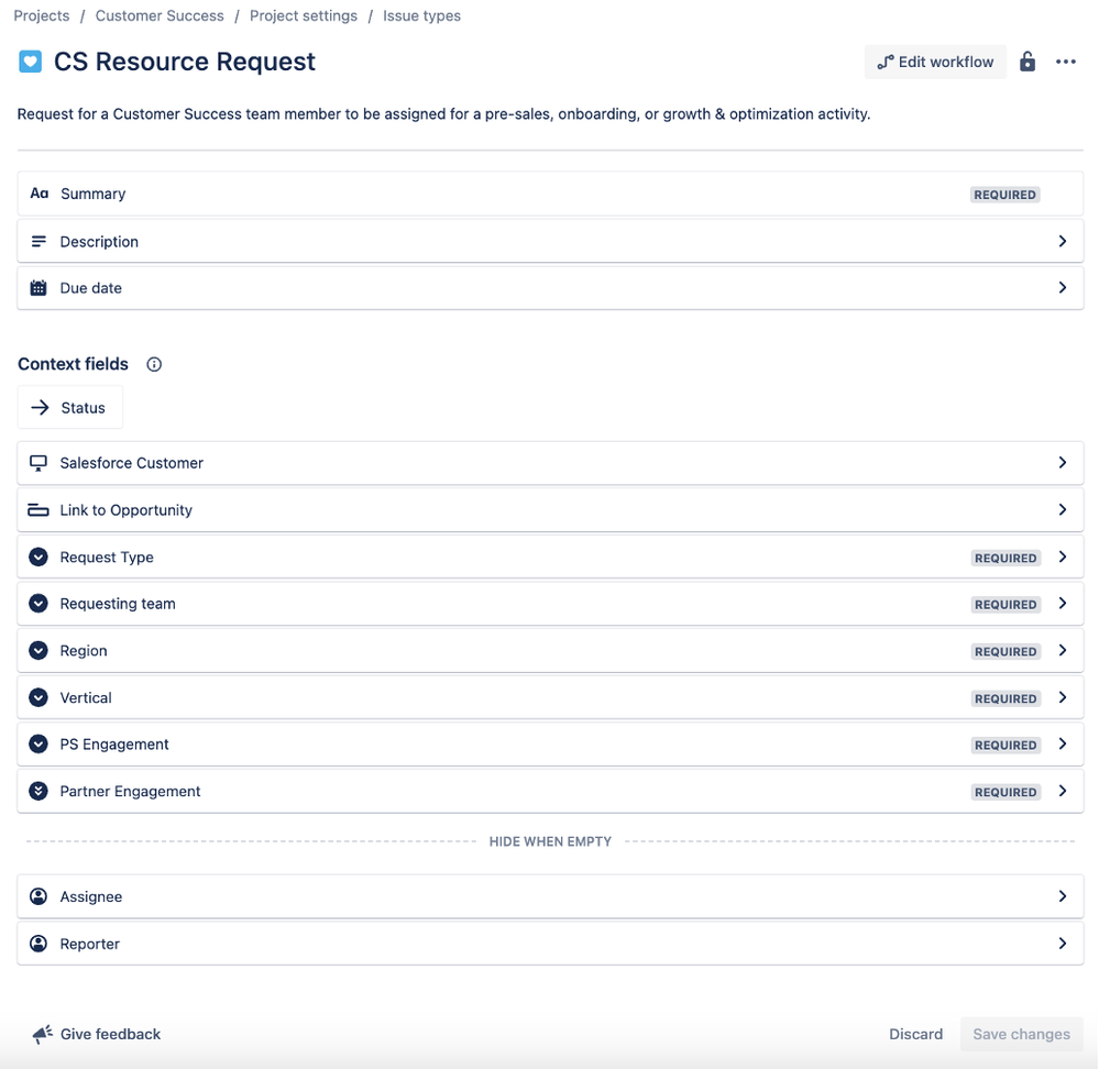

with that said, let's look closer at your issue. There's some missing information that would allow me to better assess what is going on. However, what I would suggest that you look at, and potentially share in a screenshot here is the screen config for the issue type in question. You will note that there is one section that is labeled Hide when empty. So if there are fields under that heading that are indeed empty, then they will not appear on the screen. In any event, it would be good to see a screenshot of this, and explain what fields are missing, and along with that a screenshot of what you were viewing that illustrates the missing fields.
Mark Woodward
October 12, 2023
Hi @Jack Brickey
Here's a screenshot of the CS Resource Request issue type

Here's a screenshot when using the Create button in the project to create an issue
