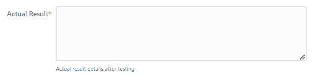

I have this one field called 'Actual Result'. In the field configuration, it is marked as optional but when I go to creating an issue with this field, it shows as required. Other projects with the same field configuration shows optional and it is working as intended. I have tried reindexing both project and Jira to no avail.
Any ideas to rectify this? It is supposed to be optional.

Thank you so much for the reply. I accepted your answer as the issue was the field was mapped inside Behaviours. Removing the field solved it.

Thanks for your reply. I have found the culprit that makes the field mandatory.The field was mapped inside Scriptrunner's Behaviour. Removing it from Behaviour solved the issue.
