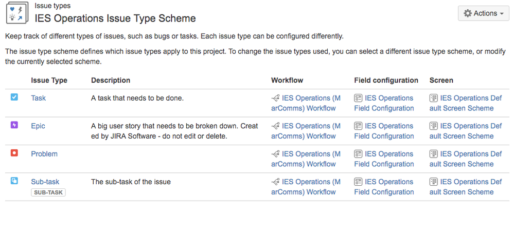

Below is the Issue Type configuration for the project
As you can see, it's all configured for the same scheme.

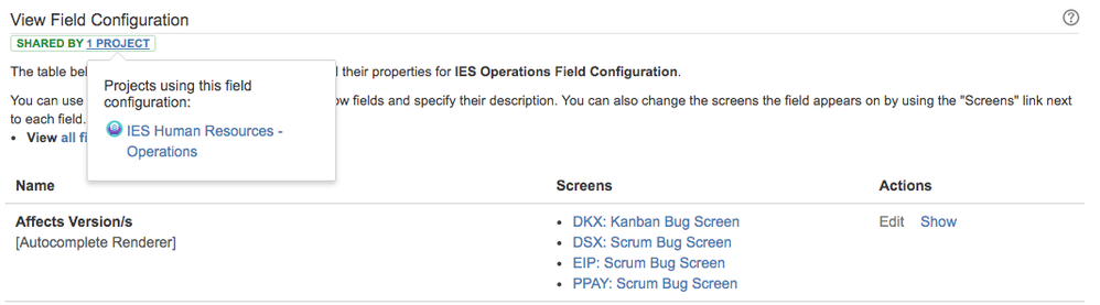

Now if we look at the Field configuration for IES Operations
Note the project it is associated with and note that Affect/s Versions is hidden. Also note the Screens (it is not on any IES Operations Screen)
Now is we go to the project and try and create an issue I can see Affects Versions and numerous other hidden fields.
