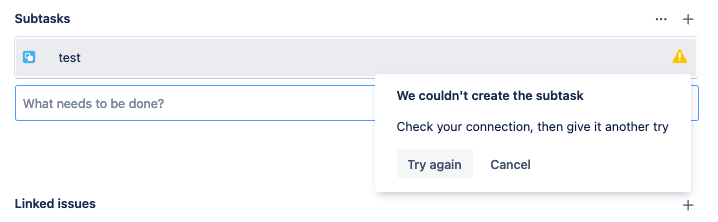

I was able to replicate this issue only when the default assignee (usually the product lead) of the project doesn't have assign permission.
With this said, it's important to check on Project settings > Details if the project lead is someone with permissions on the project, otherwise, change the default assignee to "Unassigned".
If you mentioned that it started after changing the workflow, so please, also compare the previous workflow with this new one, it may have some post function or validator on the create issue transition causing the problem.
