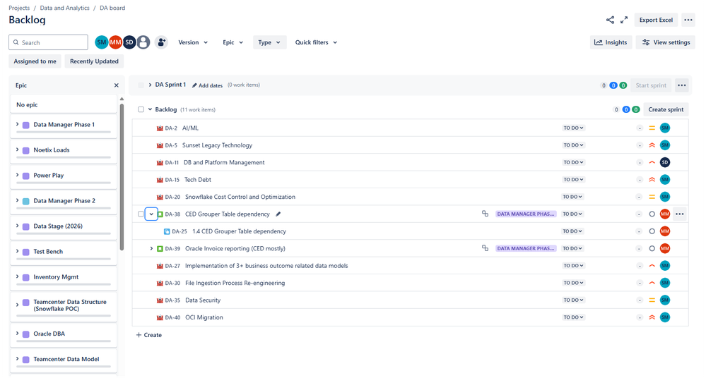

Any idea, why Backlog is not showing the hierarchical relationship from Initiative down to the Sub-task for all the Initiatives I have? It was working fine before Initiative was introduced to my board as a parent of Epic.

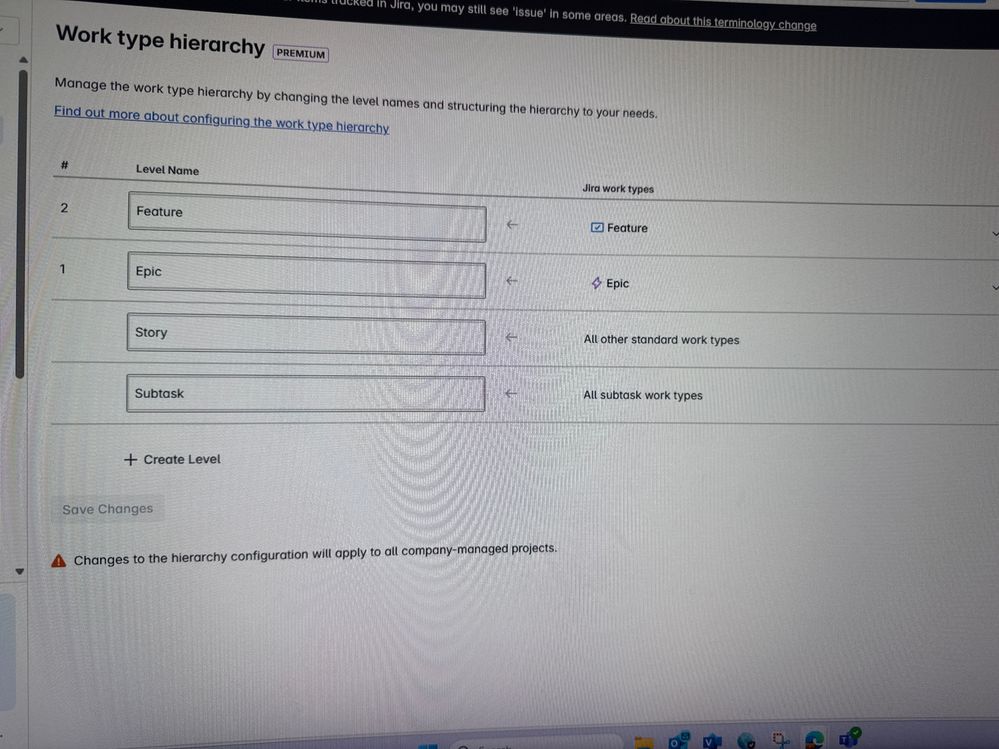

I need help with this also. I want to be able to implement this hierarchy: Epic-Feature-Story.
When creating features I’m able to select the epic as a parent but when I create stories it won’t let me select a feature as a story parent. image.jpg

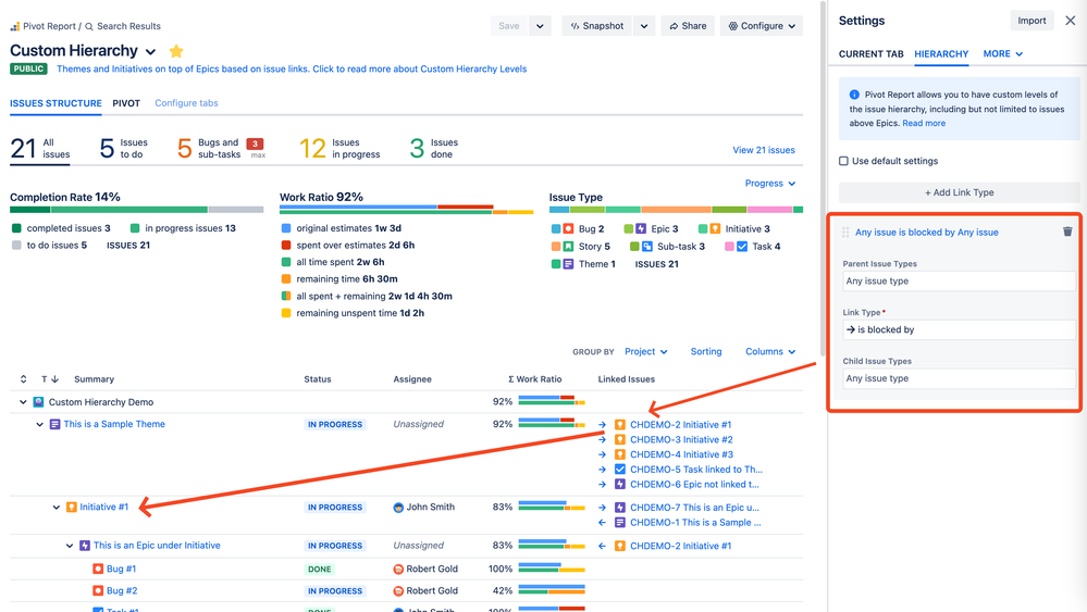

You can try an alternative method by using Pivot Report we develop:
This demo report is available here: https://demo.colined.com/plugins/servlet/pr/report?report=3
Basically, you can define your custom hierarchy based on issue links. It can be done on the saved report level or applied universally on Jira level. That allows you to easily experiment with reporting without any interference to other users and projects.

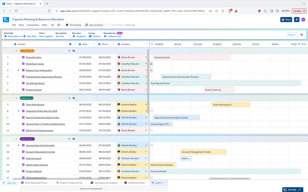

E.g. the example below where I've created a Gantt chart in Visor, and grouped my epics by a custom Visor field I created called Product.
What you're asking to do (to create a custom hierarchy level between epics and stories without establishing it in the hierarchy in Jira itself) is a bit less straightforward, but possible.
Is your admin open to creating another issue type and calling it "Feature"? It doesn't need to sit anywhere in the issue hierarchy.
If so, then you can do this:
1. Import your selected Jira projects into Visor
2. In Visor, drag and drop your Features issues below the matching epic, and drag your stories below the matching Feature (see closeup screenshot below)
3. Click on Sync & Import, then click the Settings cog icon,
4. Click on "Show default data structure options" and select "Ignore Nesting From Jira"
Now when you sync and import updates between Jira and Visor your Visor views (tables, Gantt charts, timelines, etc.) will maintain your custom nesting.
This gives you a way of visualizing your Jira project data as epic>feature>story without needing to implement that across your organization
